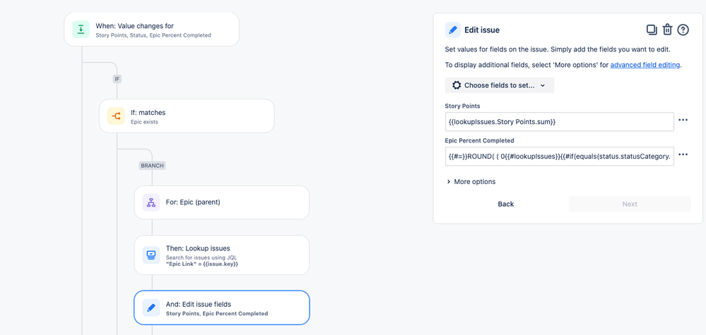

I am working on a automation (testing in One Atlassian) that will allow for a more accurate story point roll up based on story points rather than how many stories were completed.
The automation should add up and average all the story points on child issues and update a custom field called "Percent Completed" on the Epic.
This is the smart value I plugged in for the field "Percent Completed" in my automation:
{{lookupIssues.Story Points.completed.sum.divide(lookupIssues.Story Points.total.sum).asPercentage}}
The automation is not populating the field. Could these be an issue of how the math expression was done using smart values?
Is there a better way to accomplish this using automations?
Here are screenshots of my automation:
Thank you!
Hi @Rimsha Khan -- Welcome to the Atlassian Community!
FYI there are several posts in the community for this specific scenario, so it is often helpful to search around for those; some may exactly match what you need.
What you tried with dot-notation on the status / completed state will not work as "completed" is not a function. Instead either multiple lookups are needed or filtering can be used.
Back to your question, there are several ways to solve this, and to minimize the changes to your rule you could use smart value, list filtering and math expressions. I encourage you to review those linked sources to help learn more about rule writing.
For example of an approach to solve this:
{{#=}}ROUND( ( 0{{#lookupIssues}}{{#if(equals(status.statusCategory.name,"Done"))}}+{{Story points|0}}{{/}}{{/}} ) / {{lookupIssues.Story points.sum|0}} * 100, 0){{/}}

@Bill Sheboy Thank you so much for your help! I was able to use your example approach, and achieve the results I was looking for. I browsed sever atlassian community posts and found some helpful tips. Appreciate your quick reply, and detailed answer.

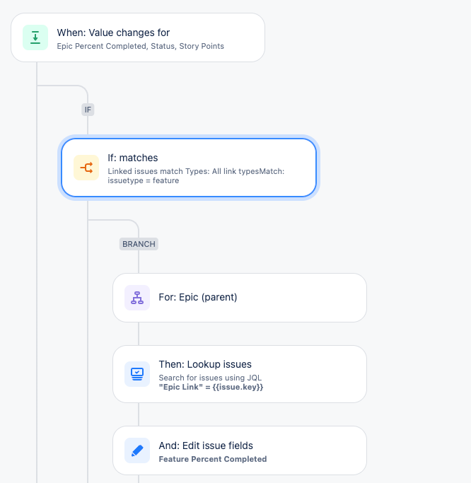

I am facing a similar issue when trying to re-create at the feature level. I've tried a variety of changes and searched through the Atlassian Community.
The issue hierarchy is Feature > Epic > Story. I would like to see a roll up from the weighted epics at the feature level, using the epic percent completed I was previously calculating.
I created a field called Feature Percent Completed and used the modified the below expression, that you previously shared.
{{#=}}ROUND( ( 0{{#lookupIssues}}{{#if(equals(status.statusCategory.name,"Done"))}}+{{Epic Percent Completed |0}}{{/}}{{/}} ) / {{lookupIssues.Epic Percent Completed.sum|0}} * 100, 0){{/}}
Additionally, in my automation, I made the following changes:
I am getting an error with the "Linked Issue"
How can I have it run where it will look at the epics linked to the feature, and use the field "Epic percent completed" field on each epic to calculate the feature percentage complete?
Any guidance would be greatly appreciated!

For the feature issues, percent completed is how you initially described it. I need it to calculate based on the "percent completed" field in the epics
Here is how I have updated the automation. I am getting a "No actions performed" status.
If you want to update the feature, I believe the trigger / conditions should proceed if:
For the primary case, you probably want something like this:
Again please note, this will be less accurate due to differences in the individual Epics which are only summarized by their Epic Percent Completed field.
@Bill Sheboy
Here is what I have now, the below automation should update at all 3 levels. The first portion is working properly to update the epic percent completed field at the epic level. The second half is still not calculating/updating the Feature percent completed field at the feature level.
I've tried a variety of things, but nothing is getting it to populate at the feature level.
The parent link field is essentially sunset, replaced by the parent field consistently across the issue hierarchy: https://community.atlassian.com/t5/Jira-Software-articles/Introducing-the-new-Parent-field-in-company-managed-projects/ba-p/2377758
Please update your rule's JQL accordingly and re-test.
Next, have you confirmed you have the correct smart values for your fields? Smart values are name, spacing, and case-sensitive. When an incorrect smart value is used, it is replaced by null, and often does not lead to rule errors.
To confirm the smart values for your fields, please use the steps in this how-to article: https://support.atlassian.com/cloud-automation/docs/find-the-smart-value-for-a-field/
Finally, sometimes the audit log details are unclear what is happening in rule progress, particularly when the if / else blocks are used. It may help to add specific writes to the log to confirm what is happening.
