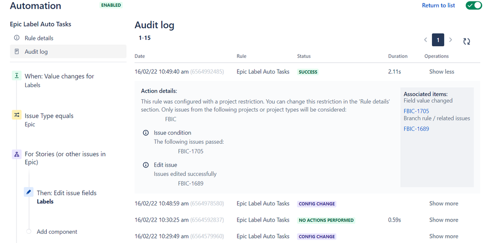

Audit log looks like it ran successfully and even shows the Epic ID and then it displayed the tasks but didn't change any of them.

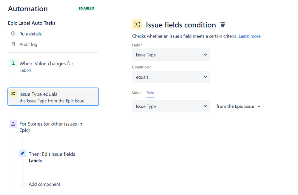

Once I changed the "Issue type equals" then it doesn't run at all as the error says the Epic didn't meet the criteria.
Here was the successful audit log from my initial automation using the JQL that still didn't update the labels on the tasks:

Sorry quick update.  I changed Issue Type equals Epic.
Audit says success.
But still no labels updated.

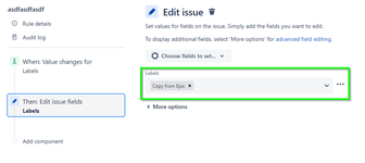

How did you configure the final action? The action needs to be told "how the issue should be editted" (eg. see screenshot, guess that fits your requirement)

Harry Tye
February 16, 2022
Thanks that was it.  It was blank.  Which is why i got no errors but nothing was completed.
I appreciate both your help.
