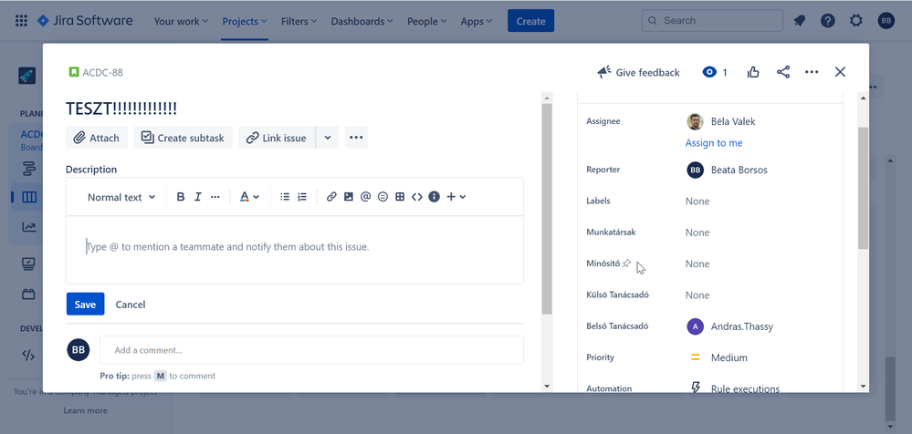

Hi Stefan,

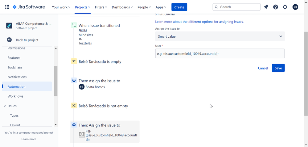

So here is how my issue is field. You can see my user picker custom fields is filled with one of the jira user, and when i move my issue, I would like him (or any user in this field) to become the assignee.
Below you can see my rule, if that field is empty than assign it to me (this part works perfectly), if the filed is not empty, than assign it to the user already in the field.

Hi @Beata Borsos
Thanks for sharing your automation rule here. In Automation for Jira the rule breaks if a condition doesn´t match. In this case every time the custom field is NOT empty the rule breaks.
To fullfill your requirement use an if/else clause instead of a simple condition and in the edit action use the above mentioned smart value. This should work fine then.

Beata Borsos
July 11, 2022
Hi Stefan,
Thank you, yes it worked,

Tim C
July 11, 2022
Take off the "e. g." in the field box - it should just be the smart value.
Beata Borsos
July 11, 2022
Thank you for your help, it worked :)
Dan Tombs
July 11, 2022
Hi @Beata Borsos
To me it looks like you are using normal if statements over an else if. The normal if statements should only be used for items that always need to be true. You have two different options so use an else if.
