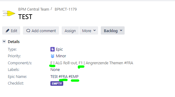

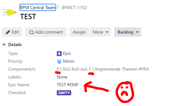

Hello all,

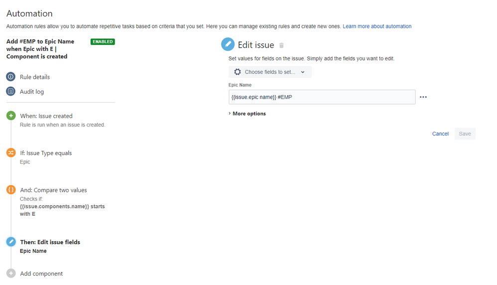

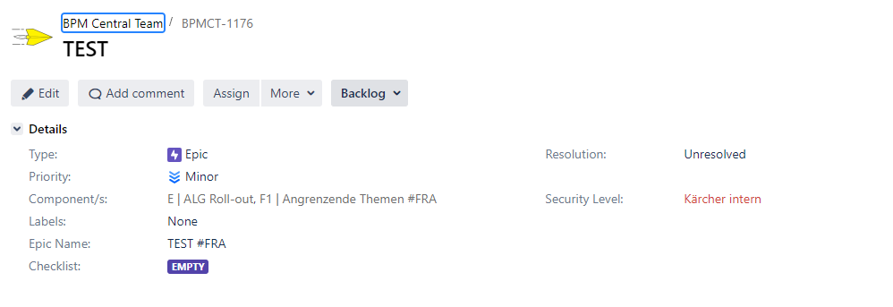

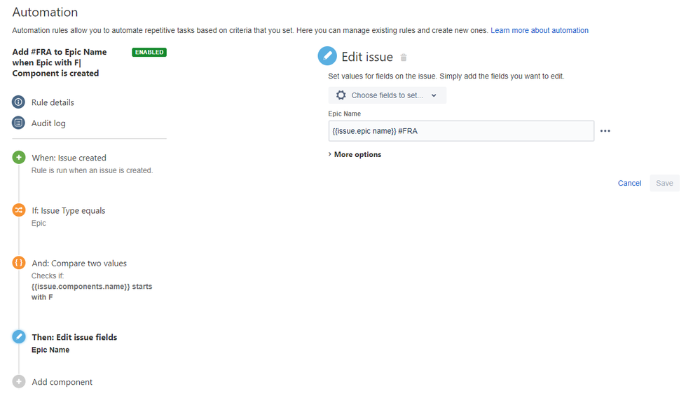

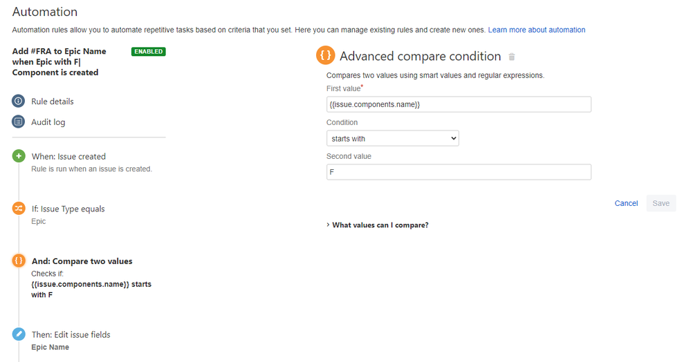

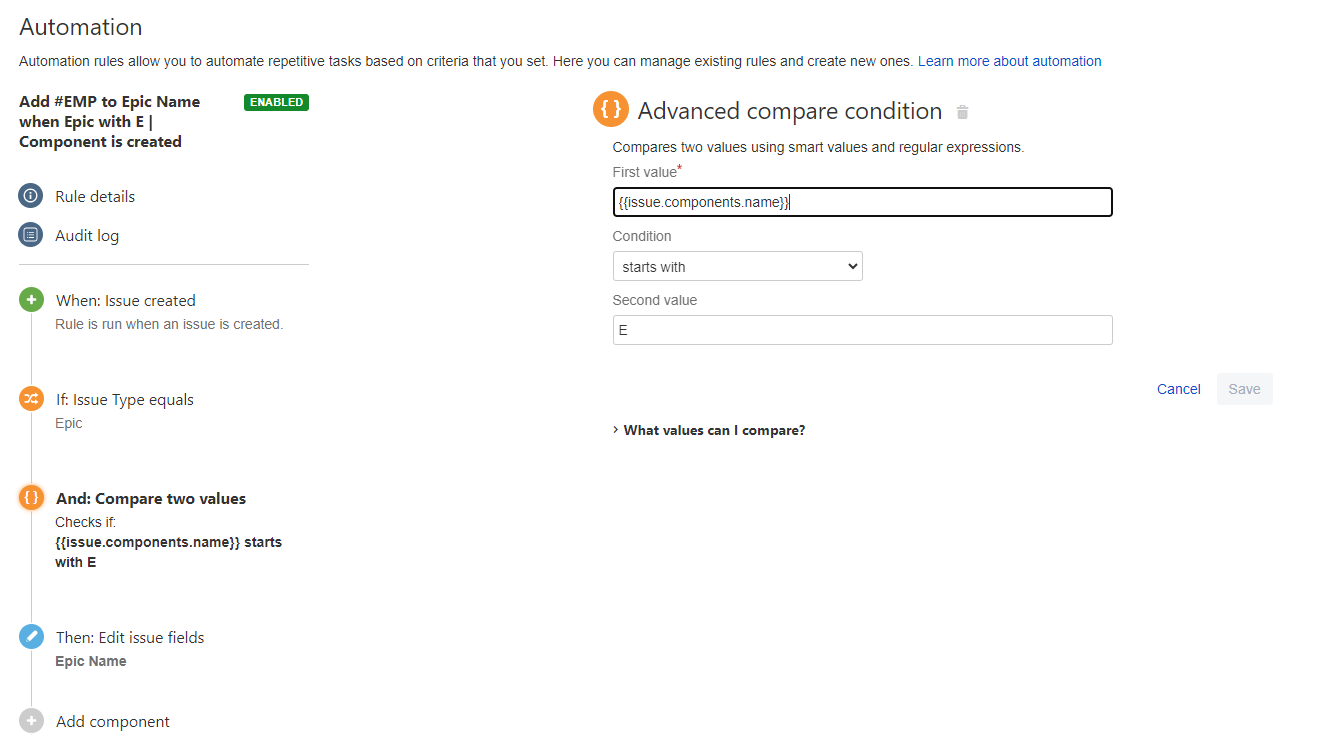

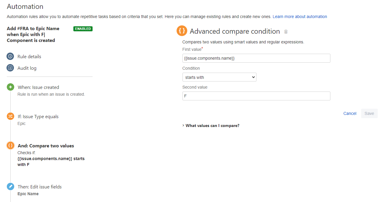

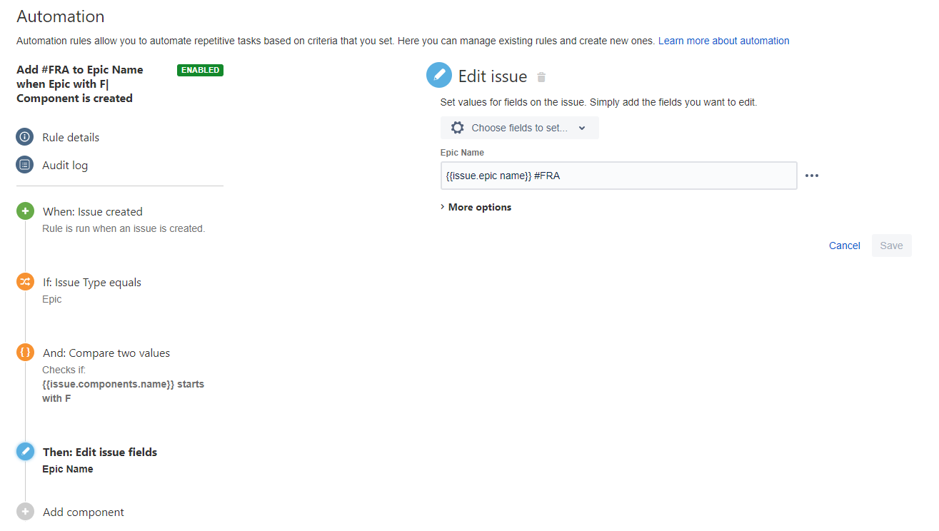

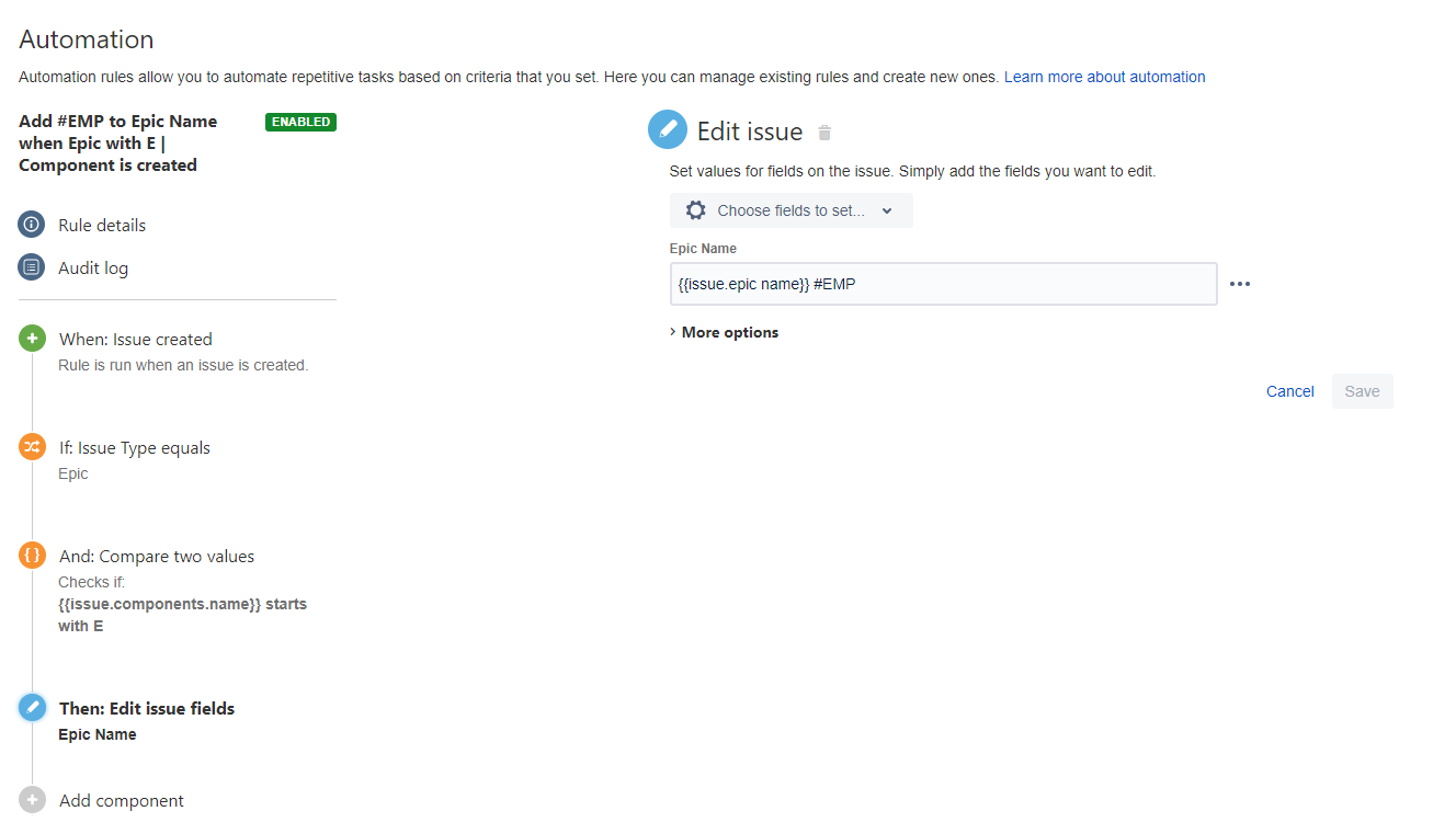

I have set up the following 2 automation rules:
  1. If in the field Component/s the component name starts with E add #EMP to the Epic name
  2. If in the field Component/s the component name starts with F add #FRA to the Epic name.
This works well as long as there is only ONE component selected in the Epic. But if there are 2 components selected, one starting with "E" and one with "F", only #EMP is added to the iEPic name...but I want #EMP and #FRA to be added to the Epic name.
Rule #FRA2.PNGRule #EMP2.PNGRule #EMP1.PNGRule #FRA1.PNGProblem_only #EMP.PNG
Any idea how to solve this?

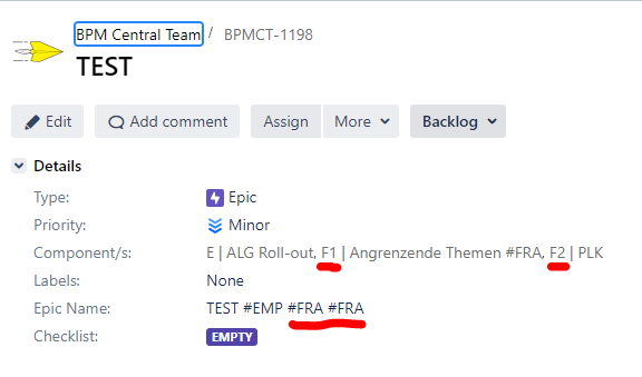

But one problem is left:
When there is already a component starting with "F" and I add a second component that start with "F", the hashtag #FRA is added once more. I only need the hashtag once in the Epic Name.

First thing, smart value expressions can be built up from simple pieces.  And something what seems like a complicate mess can be explained.  That was a disclaimer for what follows...
Your revised goal is to find the distinct first letters of the component names, and use them to select your tokens/indicators to add to the epic name.  Fortunately smart value lists have a function to return just the distinct values: https://support.atlassian.com/cloud-automation/docs/jira-smart-values-lists/#list.distinct
The challenge is how to get the distinct values and use that in a list filter?  Let's look at this step by step:
  1. Let's get just the first characters of the component names as a list with {{issue.components.name.left(1).toUpperCase()}}
  2. We refine that by adding distinct to the end {{issue.components.name.left(1).toUpperCase().distinct}}
  3. And because that is a list, it can still be filtered, like this {{#issue.components.name.left(1).toUpperCase().distinct}}{{#if(equals("E"))}} # EMP{{/}}{{/}}
The tricky part is after we got to step #2, these are now just letters in a list, and no longer have anything to do with components.  And so we cannot filter on the "name" attribute any longer.
Fortunately the iterator and conditional filter logic design is smart enough to compare the list element to the "E".
So your revised template would be this...as now this can happen together:
{{issue.epic name.substringBefore(" #")}}{{#issue.components.name.left(1).toUpperCase().distinct}}{{#if(equals("E"))}} #EMP{{/}}{{#if(equals("F"))}} #FRA{{/}}{{/}}

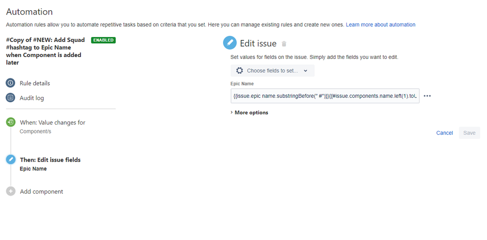

So I tried this code:
{{issue.epic name.substringBefore(" #")}}       {{#issue.components.name.left(1).toUpperCase().distinct}}
   {{#if(equals("S"))}} #STE{{/}}
But now it just removes all the hashtags from the Epic name. What might be wrong?
With this code it works nicely (except the problem that a hashtag might be added multiple times):
{{#issue.components}}
{{#if(equals(name.left(1).toUpperCase(),"E"))}} #EMP{{/}}                {{#if(equals(name.left(1).toUpperCase(),"F"))}} #FRA{{/}}{{#if(equals(name.left(1).toUpperCase(),"S"))}} #STE{{/}}
{{/}Problem.PNG

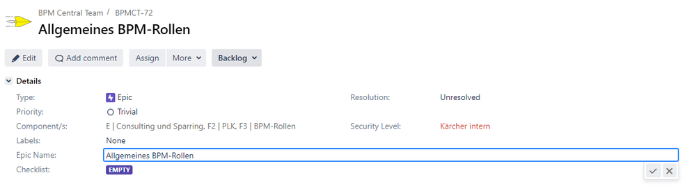

Fascinating...It is not removing them but they are off the field view on the page!  I believe if you click on the field and select all, you will find them off to the right side.
There is something happening due to the use of the stringBefore() function, the iterator, and the extra carriage returns/line feeds you have in the expression.  Please try pasting in this exact one and observe what happens:
{{issue.epic name.substringBefore(" #").trim}}{{#issue.components.name.left(1).toUpperCase().distinct}}{{#if(equals("E"))}} #EMP{{/}}{{#if(equals("F"))}} #FRA{{/}}{{#if(equals("S"))}} #STE{{/}}{{/}}
Please note I added a trim call and removed all extra CR/LF from the expression.
Daniel Schoeneck
August 18, 2023
I tried it, but still the same behavior...
And I also did not find them in the edit mode of the field:

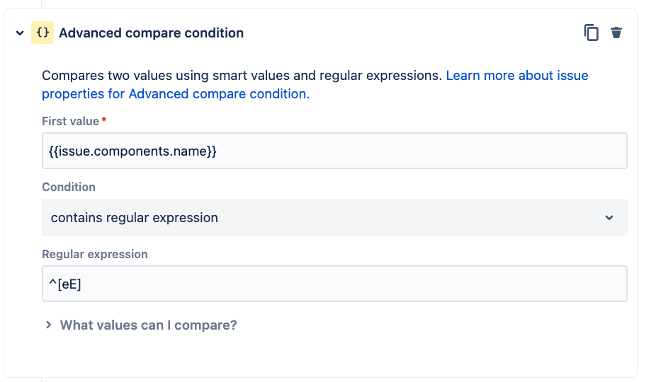

I can see your predicament. When there is a lot of changes you don't want to go back in and change the rules each time. Maybe you could extend the solution provided above with a regular expression. I don't remember if Server supports this but I assume it does. Use the branching logic that @Mark Segall provided but instead of component in you could use:
^[eE] for matching components starting with e or E
^[fF] for matching components starting with f or FScreenshot 2023-08-18 at 16.15.12.png

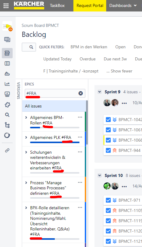

May be I need a completely different approach?
My ultimate goal is to have "hashtags" on the epics in the epic panel in the Scrum backlog (depending on the selected components in the epics), which allows to use the epic panel filter (which only can filter by the epic name...)

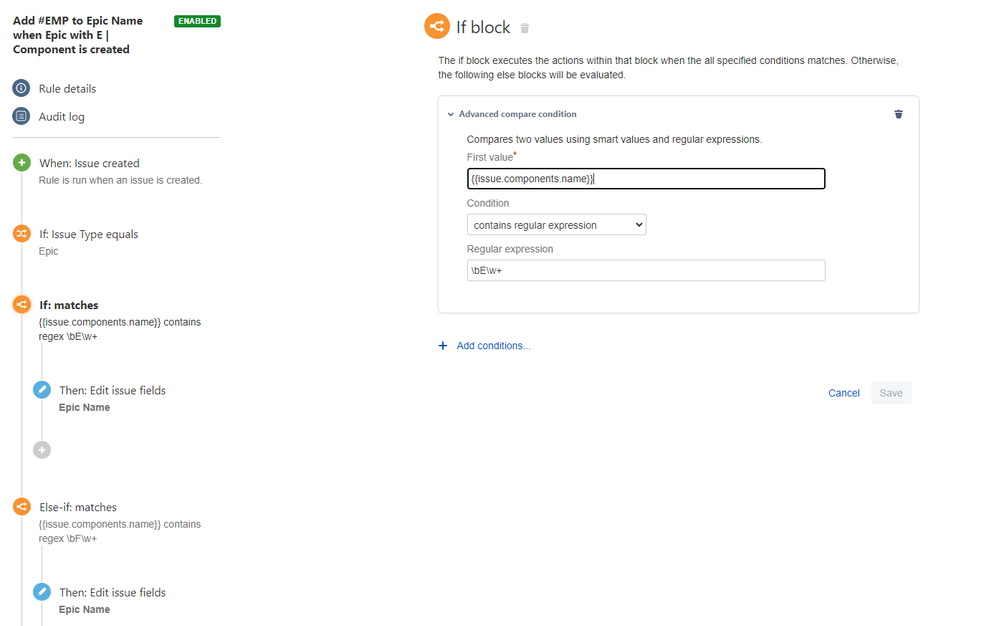

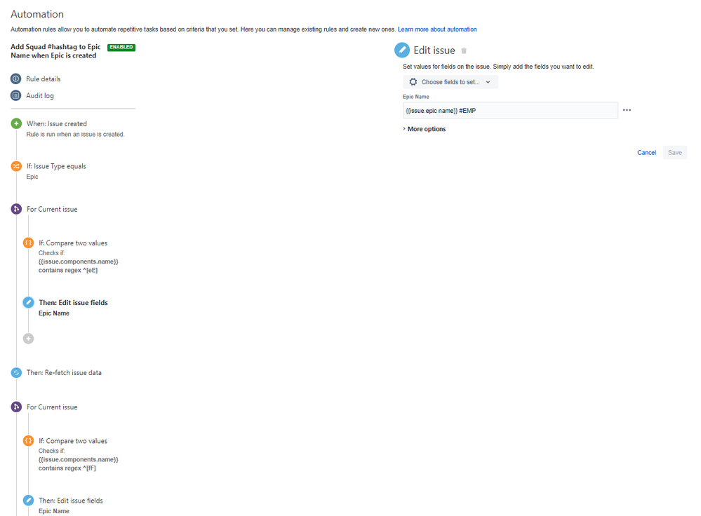

I think I found an answer to how to handle this:
  • IF CONDITION:
    • {{issue.components.name}}
      Contains Regex
      \bE\w+
  • ELSE CONDITION:
      Contains Regex
      \bF\w+
I ran through a few tests in my environment and it seems to be working.
Wouter van den Berg
August 18, 2023
Assuming each components starts with a capital. If you want to cover all options you can use:
Daniel Schoeneck
August 18, 2023

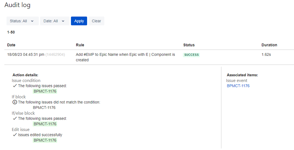

Thank you, I tried like this:
But it still only added #FRA to the Epic name although there is an Component starting with E:
Wouter van den Berg
August 18, 2023
You need to Branch. With If/Else automation will stop once it reaches a succes.
Like # people like this
Mark Segall
August 18, 2023
Good call @Wouter van den Berg
Like Wouter van den Berg likes this
Mark Segall
August 18, 2023
I would branch into current issue twice and in between the two branches, do a re-fetch
Like Daniel Schoeneck likes this
Wouter van den Berg
August 18, 2023
Together we will solve this one @Mark Segall ;)
@Daniel Schoeneck I saw you are using the Regex Mark has provided. Please make sure you have governance on Component creation. If a user adds a component without capital your rule won't pick this one up as match. The chances users will add a component without capital along the way is very likely if you'd ask me. I have added my solution for this but you are free to use Mark his solution but I still wanted to mention this again.
Daniel Schoeneck
August 18, 2023
Guys you are genius!
