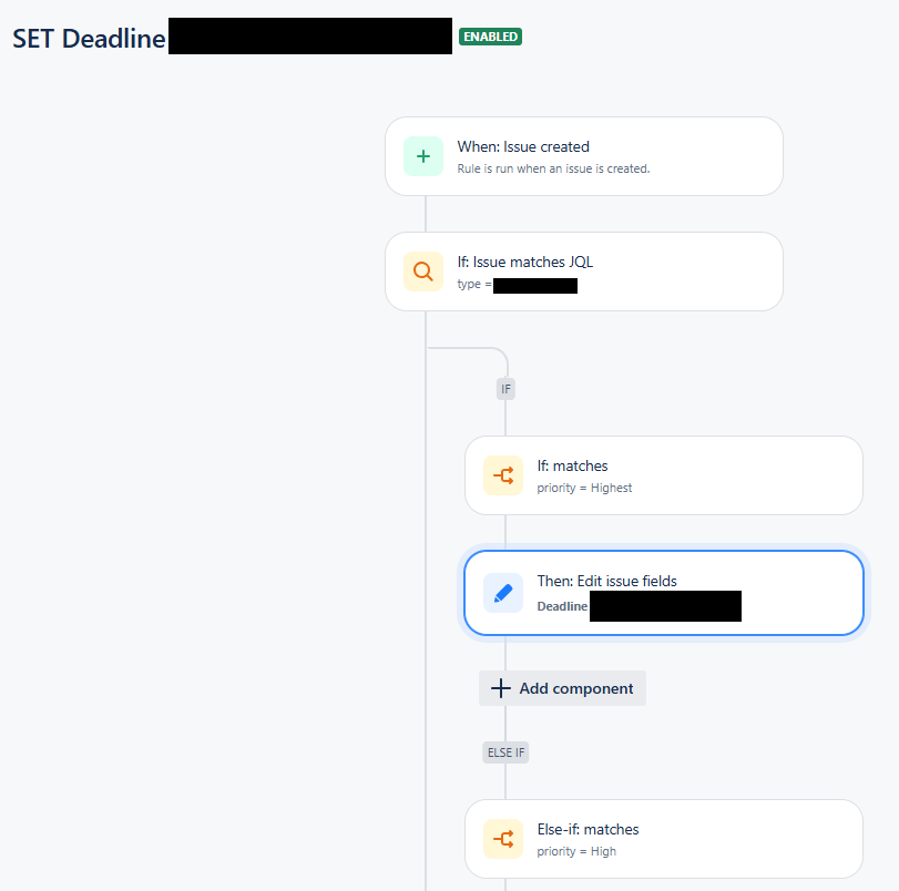

In this case, I have an automation that has the trigger of when the issue is created.
Then, I have a condition for the type of issue, but you could also have here other attributes, such as the project, project category, etc.

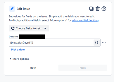

Then, I have an IF / ELSE condition where, if for the issue type specified, the priority is 'Highest' to have an action to edit the issue field to set the Deadline with this smart value
{{now.plusDays(5)}}
Then, in the Else condition, I have specified what to set the deadline to for the priority, 'High',
{{now.plusDays(10)}}
Then a further Else for the priority, 'Medium',
{{now.plusDays(20)}}

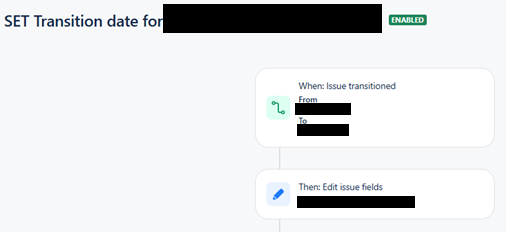

Once we have a deadline, we will need to capture the date and time in which the transition which is the target of the deadline has taken place. I am doing this with another automation rule.
Here, the trigger is the transition which the deadline is for.
Of course, you can also have conditions to limit the scope of this rule, such as specifying the issue type or project.
Then, we have the action to populate a date field with {{now}}.

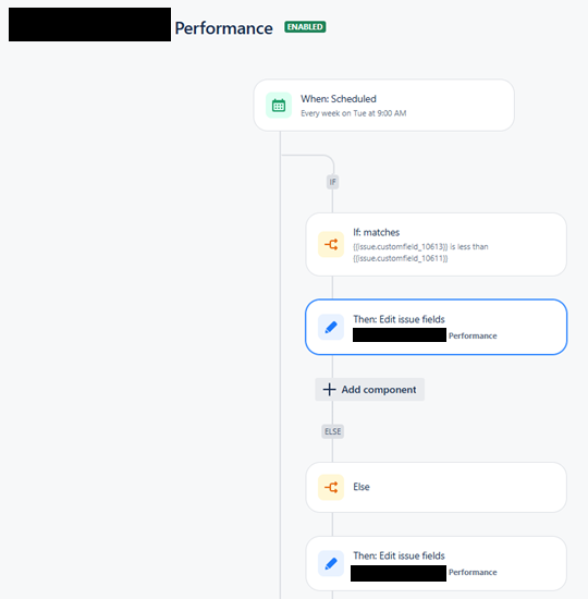

Finally, we need another automation to do the confrontation between the deadline and the actual transition date, where we can also set a value for the outcome, so comparing the two dates and where the number is negative, to set a value of breached and where the number is positive or neutral to set the value of met.
In this case, we are using a scheduled trigger, but you could also use another type of trigger if you wanted.
Here we have an IF / ELSE condition where we are comparing if the date where the transition was actually done was before the deadline date (this is the comparison we are doing between the two custom field values).
Then, we have an action for the IF to set a custom field for the performance to be 'MET', otherwise, if the actual transition date is not less than the deadline, we will have the action to set the performance to 'BREACHED'.
