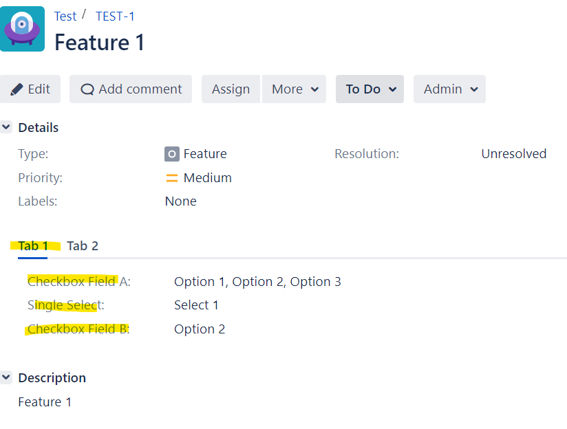

I have a custom listener script that will clear desired fields when an issue is cloned, and it works fine.
But is there a way to only grab fields that are under a specific tab?
For example:
If Tab 1 had 20+ more fields, is there a method within listeners to call those fields under Tab 1? The idea is if in the future I need to add more fields under Tab 1, I don't have to update the listener script with new fields every time.
Or is calling tabs only unique for Behaviors?
It depends how you are retrieving the fields from the issue. Those field objects may have a tab attribute you can filter them on, but more likely you would have to use a different approach to find the fields on a given tab. That is more tedious, needing to go from Project to the Issue Type Screen Scheme, then with the Issue Type go to a Screen Scheme, then from there to a Screen, which should have the tab info.
