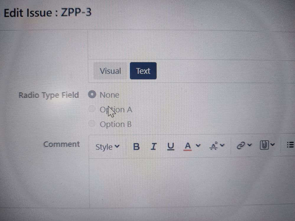

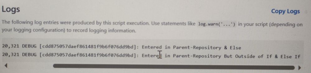

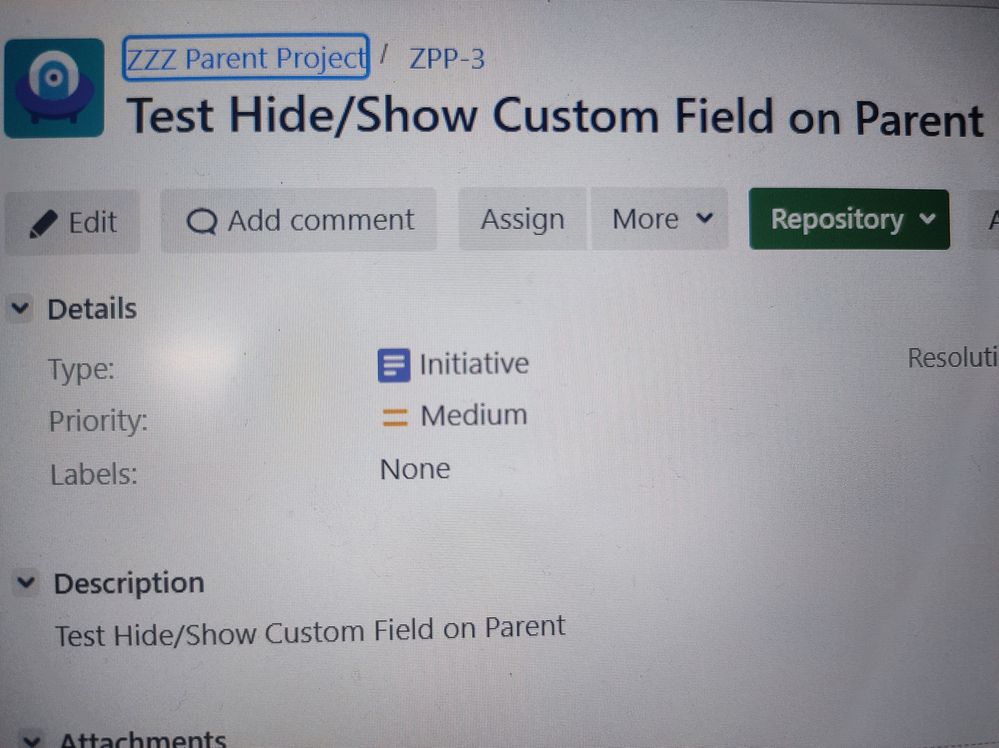

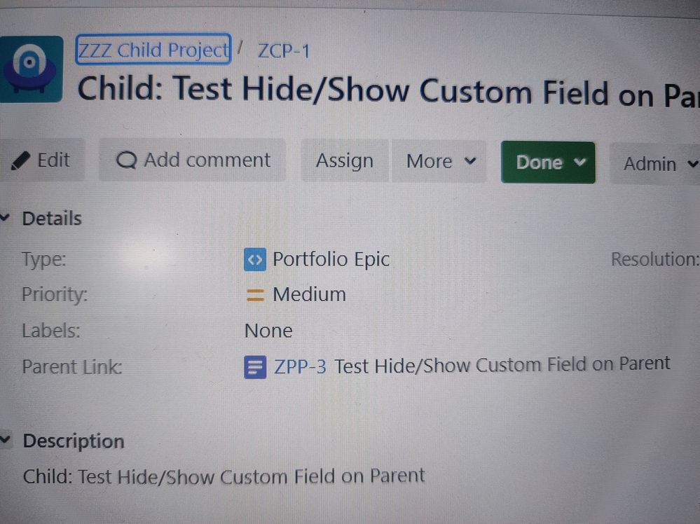

Digvijay Singh Gehlot
April 20, 2025
@Salih Tuç
Please find related screenshots below:
Parent in Repository
Child in Done with Parent Link
Radio field is ReadyOnly on Parent issue - instead it should be in Editable and Required on Parent issue if Parent is in Repository and Child is in Done
Log debug at this time
