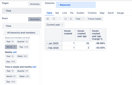

You can use Standard "Time ago" calculations in eazyBI to build this report.
Here's what you can do:
  • add Time dimension in Rows. In my example below, I have selected a "month" level member. You can also add Time dimension to Pages and select "Current year" member to filter by it.
  • select "Issues created" under Measures
  • left-click on "Issues created" and select "Add calculated" -> "Time ago" -> "year ago" and "year ago change %"
I hope this helps.
