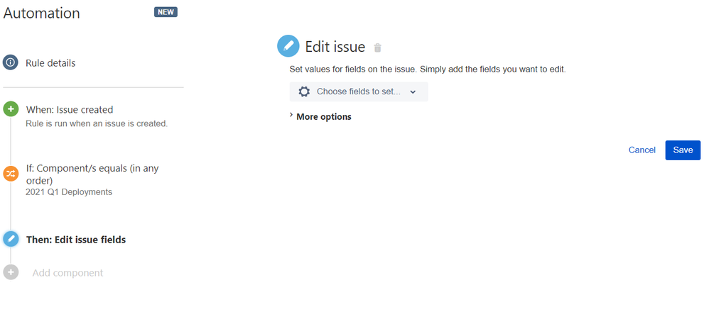

CHINNAMUTHEVISAI.SATYANARAYANASHARMA
May 16, 2022
Hi
You can do it by Automation Rules i think.
in component/s select the value you want.
in edit issue select a field you want add value's there.
Geetanjali Sharma
May 16, 2022
I don't think this will work as this will run once the issue is created, I want to put the condition while creating the issue.
May 16, 2022
Yes this will run once issue is created then its my wrong understanding
Geetanjali Sharma
May 17, 2022
Yup! tried that option, anyways thanks for your input.
