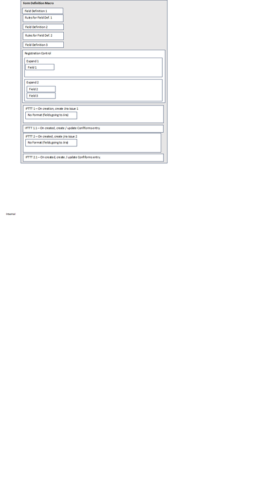

Thanks @Alex Medved _ConfiForms_  for your help with this.  Both of my IFTTT's to create the issues and feed the JIra ID back to the form work, but only for the IFTTT's that are first.  I've created a mock-up to demonstrate the set-up I've used.   Are things in the correct order and placement?Intake Form Design Outline for Atlassian Support Ticket.png
September 10, 2024
What do you mean by this?
