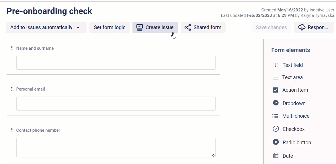

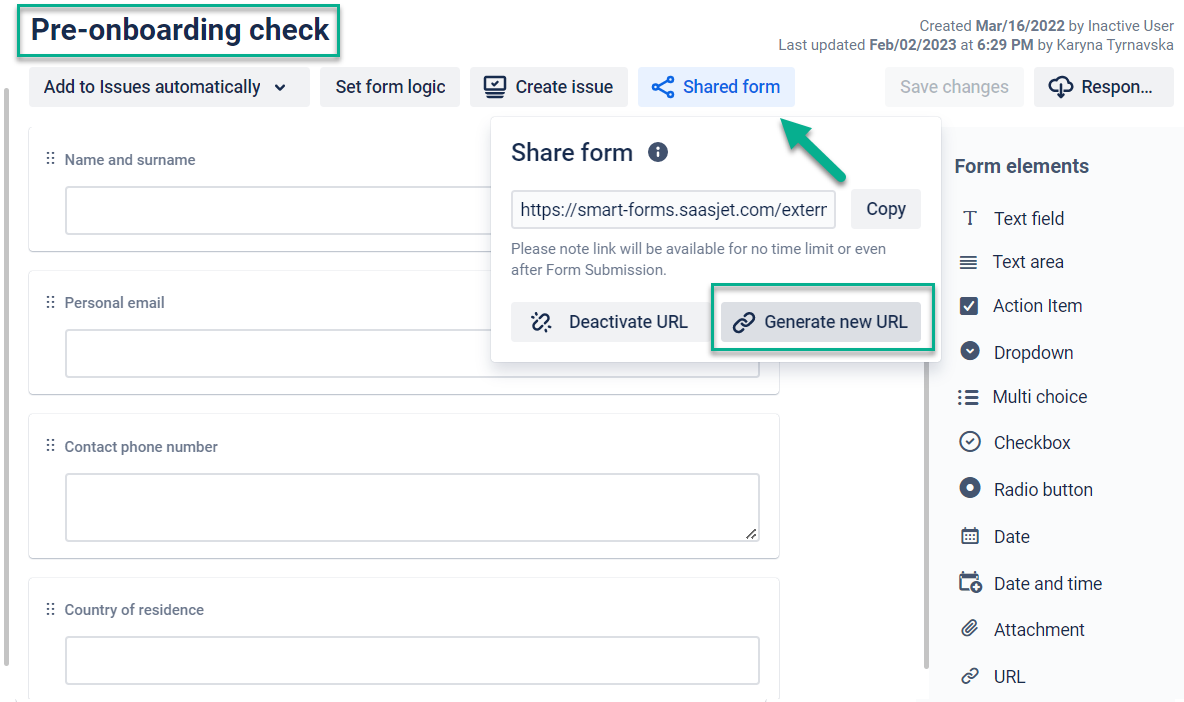

- Create pre-onboarding form using Smart Jira Form add-on. If necessary, add form logic so that the form is dynamic and adapts to your need. With Smart Jira forms you can generate a public URL and share it with the applicants who should submit it.

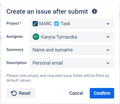

- Next, in order to create task based on submitted form, you need to click the Create issue button and fill in the settings. Read more on how to do it step by step.
- After the user has filled out the form, according to the fields we used in the previous point, a task for HR will automatically be created in the project you specified and for the assignee you chose.

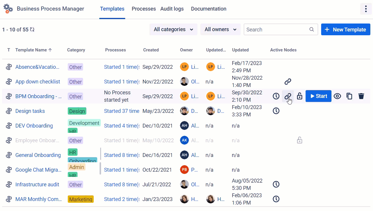

- For the next step, you need to combine Business Process Manager (BPM) and Jira automation. Go to add-on and create a new BPM process template for onboarding and copy the URL of the template to connect the creation of the process with the automation trigger. With BPM, you can work with several departments at once, and this greatly optimizes and speeds up your workflow.
- Create a new rule with automation, according to which the process in Business Process Manager will start as soon as the task created after the submission of the form goes to “Done” state.
