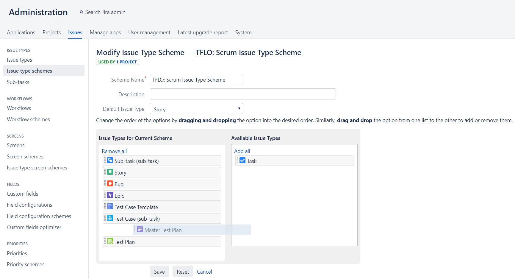

Secondly, we will add this issue type to our issue type scheme to use it in our project.
- Go to Jira Administration > Issues > Issue type schemes
- Find the scheme associated with the project in which you would like to have the Master Test Plan issue type and click Edit
- Drag the Master Test Plan issue type from Available Issue Types to Issue Types for Current Scheme and save the changes
The Master Test Plan issue type is now available, but we need to do a few more things to get it fully functional.

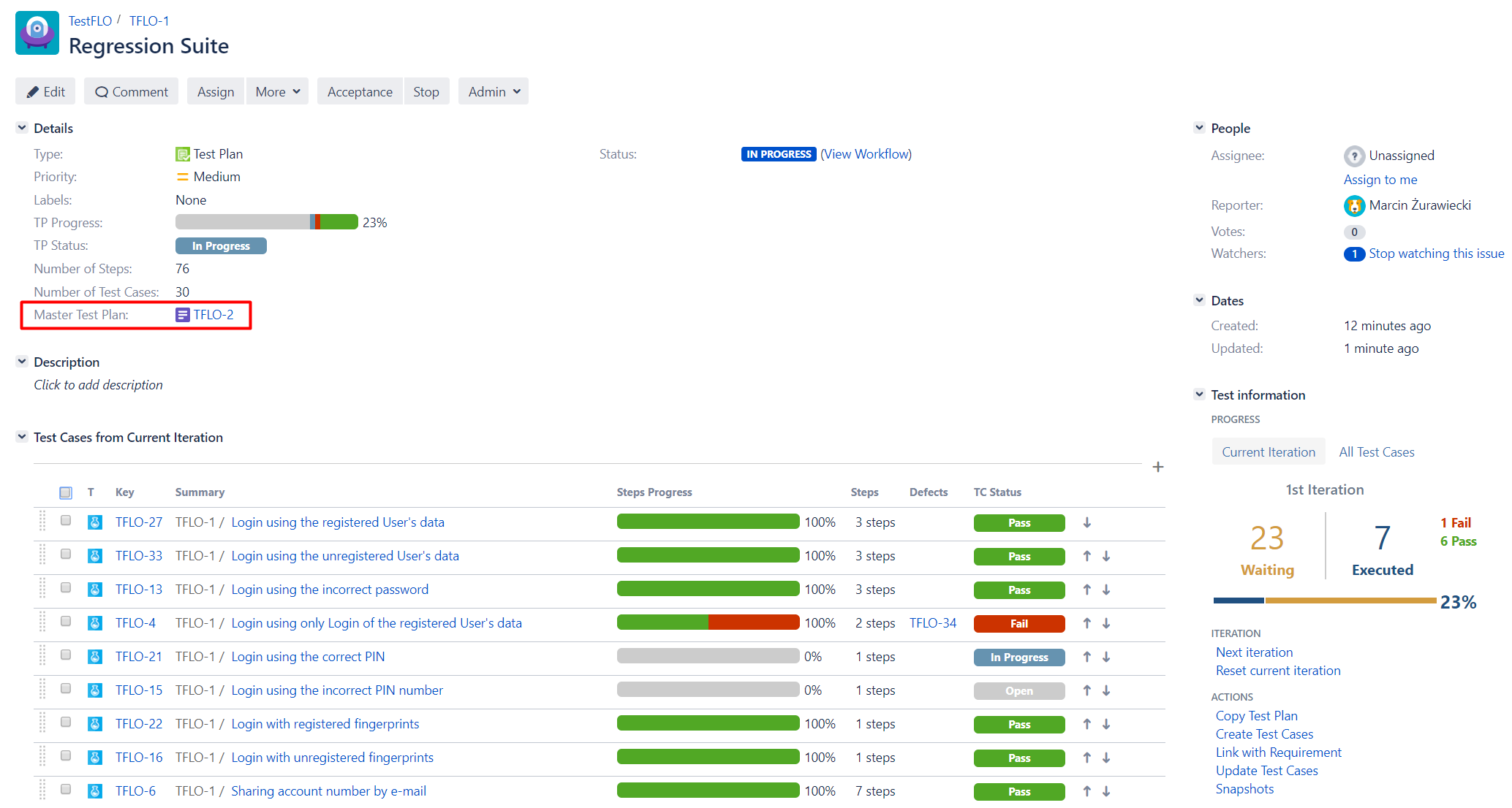

Master Test Plan field
After adding the Master Test Plan issue type, we need to have a method for creating relations between Master Test Plans and Test Plans. We’ll use the Enhanced Issues Picker custom field for this purpose.
- Go to Jira Administration > Issues > Custom field and click Add custom field
- Use the Advanced filter, find TestFLO - Enhanced Issues Picker CF field type, select it and click Next
- Name the field “Master Test Plan” and click Create
- Select the screen or screens associated with the Test Plan issue type and click Update
- Configure the field using the gear icon menu
- Set Jira-like issue searcher to ON. Optional: set Many values to ON if you want to link a single Test Plan to multiple Master Test Plans. Optional: set the Issue type and project restrictions if you want the field to accept only Master Test Plan issues
We have set up a Master Test Plan field that allows us to link Test Plans with Master Test Plans. In the next step, we will create a panel to display Test Plans on a Master Test Plan.

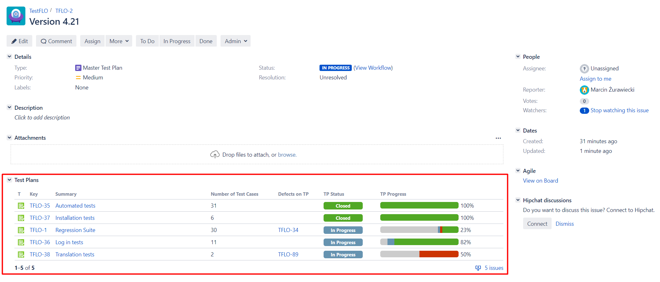

Test Plans panel
The most important benefit behind implementing a Master Test Plan is increased transparency when using multiple Test Plans. To achieve this goal, we have to add a new Panel Filter Result (PFR) panel on the Master Test Plan issue view.
- Go to Jira Administration > Add-ons (or Apps) > TestFLO > Panel Filter Result and click Add Panel
- Set Panel title: Test Plans
- Select Project: the project with Master Test Plan issue type
- Set Issue Type: Master Test Plan
- Set JQL: issuetype = “Test Plan”
- Set Placeholder condition: ‘Master Test Plan’ = _ISSUE_KEY_
- Set Columns config: Custom configuration
- Set Custom Columns: select the columns displayed in panels according to your needs and fields available on Test Plans
- Click Update
We are almost ready. Test Plans linked with Master Test Plans through the Master Test Plan field are now visible on the Master Test Plan issues in a convenient panel. The last thing to do is adding a progress field that will show the overall progress of all Test Plans on the Master Test Plan view.

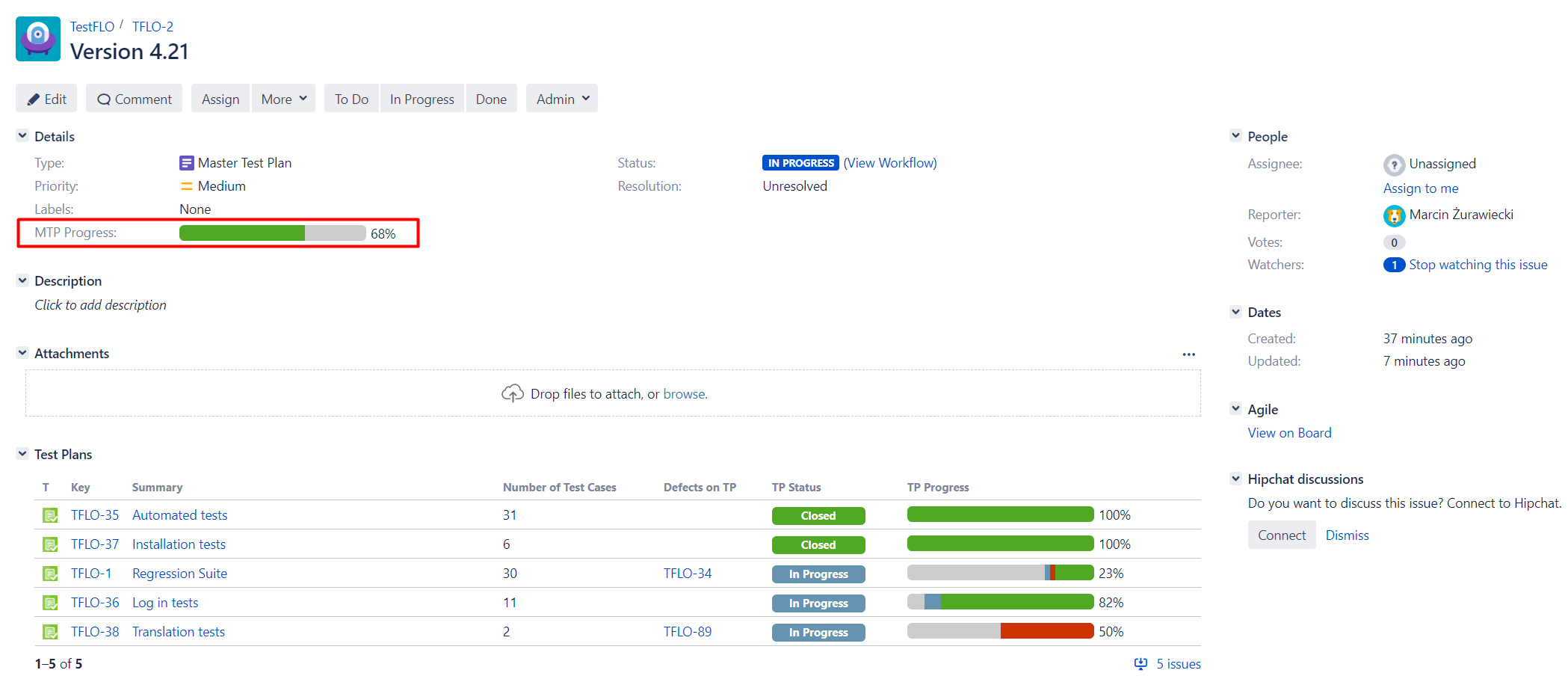

- Name the field “MTP Progress” and click Create
- Select the screen or screens associated with the Master Test Plan issue type and click Update
- Set the Issue panel option to the panel created previously (on the Master Test Plan issues). Set the Source CF option to the progress field visible on Test Plans. By it’s the TP Progress field
That’s it! Our Master Test Plan issue type is ready to go.
