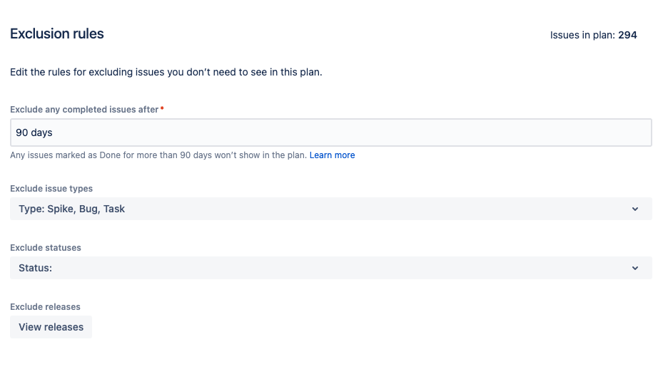

I'm experiencing the same issue. I have a plan comprised of Initiatives, with Epics nested underneath. I would also like to show a small selection of stories that are not associated with Epics in the plan. When I set the plan hierarchy as `Initiative` to `Story` I see all my stories, tasks, bugs, and spikes. I have tested exclusion rules to exclude spikes, bugs, and tasks, leaving me with all the stories associated with the projects that populate the plan.

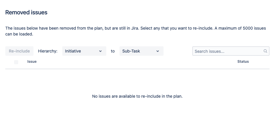

However, when I go to Removed Issues, there's nothing to re-include.

What I want to do is add stories to the list of excluded issue types and then selectively re-include some based on a label or custom field (open to either approach). There are no plan filters applied, and the stories I'm trying to include are all in mapped statuses.
How can I get stories to show up in the Removed Issues list for reinclusion?
