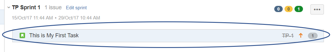

     I was wondering if someone can help me with something that I thought would be straight forward but has actually taken up my entire morning trying to figure out :( . I recently began using JIRA Cloud and my problem is that when I set up a sprint and complete a story in that sprint I want to see a strike through on the name of the story I've just completed.
For example, The story called 'This is My First Task' when I complete this task in my sprint I want to see the following 'This is My First Task'
How can I do this?
Thanks again
Eamonn

This is not possible only the Story Key will get striked out.

Thanks for your quick reply Mizan. This is unfortunate as in previous versions the strike through on the summary made it very clear on what was done in a sprint. For it to be just done on the story ID makes it quite hard to read.
Would you know if there another way to effectively show completed tasks in a sprint?

IIRC , the summary was not striked out. It seems the Board configuration has changed. Due to which the Issue key appears after summary.
On the board go to Configure >> Card Layout >> Backlog
Add the field resolution. This will help you identify which ones are completed. Also make the Issue Key appear before summary . It will be better to identify the ones which are resolved/completed

  Thanks for your help on this but it looks like this was a fundamental change made by Atalssian.
I personally do not find this change helpful as it makes the backlog hard to read but reading from other forums it looks like they are not rolling back on this change or even give the user the option to re-arrange it.

Jira will strike out a summary in many (but not all) places when a resolution is set on the issue.
