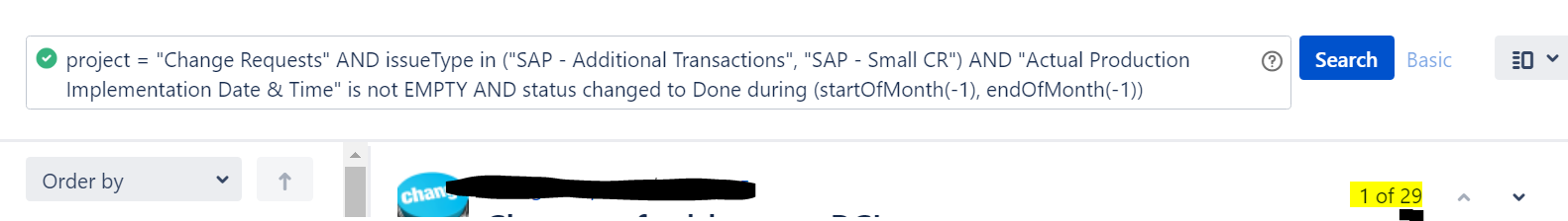

Filter using:

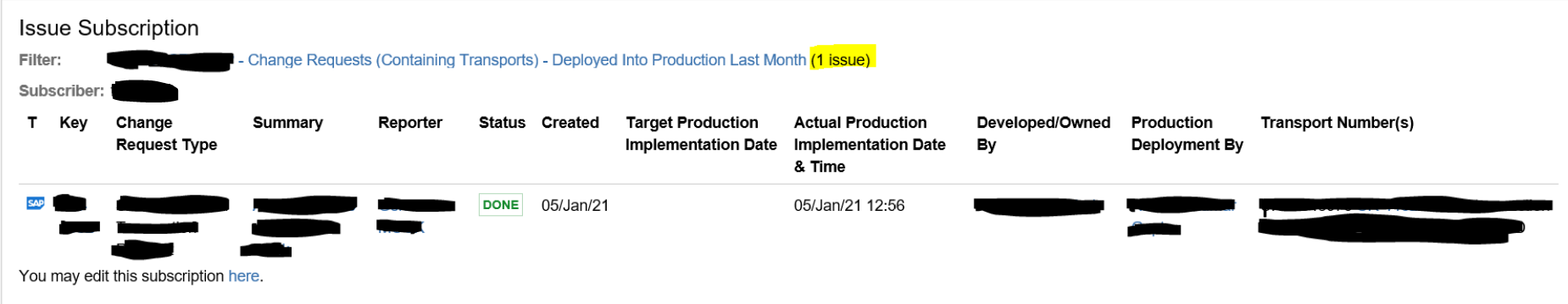

This return 29 items if I search it using the above filter.
But if I add a subscription to the filter it return inconsistent results sometimes I would get 1 item and sometimes 3 items via the email.

The issue subscription currently shows 1 issue - from your screenshot but the filter gives back 29 results.
Can you in first step compare what is different with the 28 vs. the 1 issue?

Hi @Daniel Ebers
I have compared it and they have the same information based on the filter query. Also each time I run the subscription manually it gives me different items via email.
