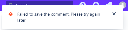

The exact error is "Failed to save the comment. Please try again later".

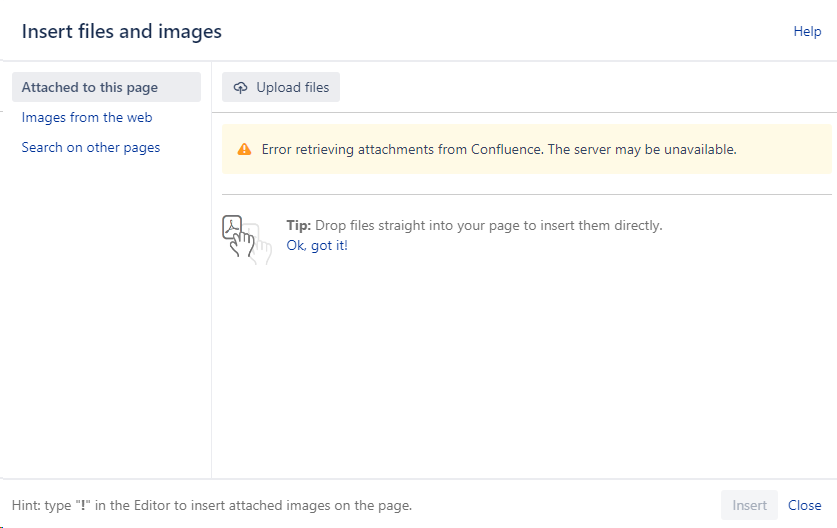

I also have another observation, don't know if it is related. When I edit a page I can no longer see the uploaded images.

The image issue is most likely part of this reported issue https://jira.atlassian.com/browse/CONFSERVER-45746
