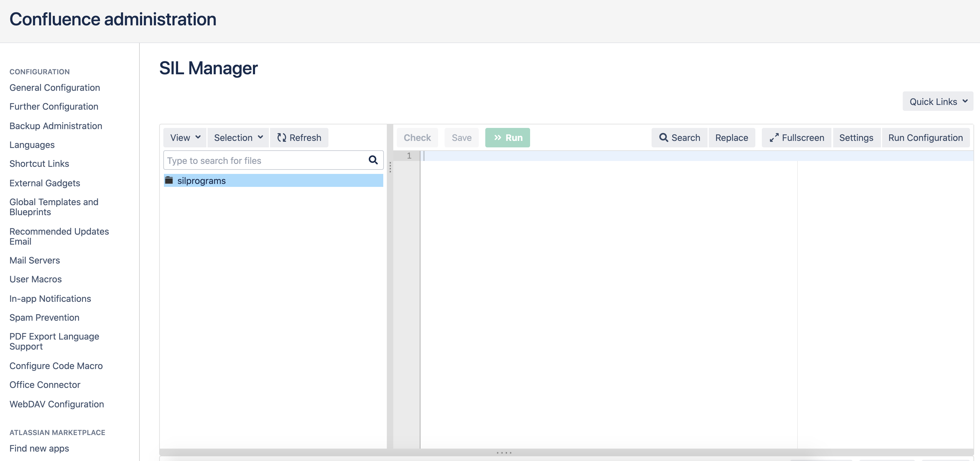

Write the script
Now go to cog item -> Manage apps -> SIL Manager.

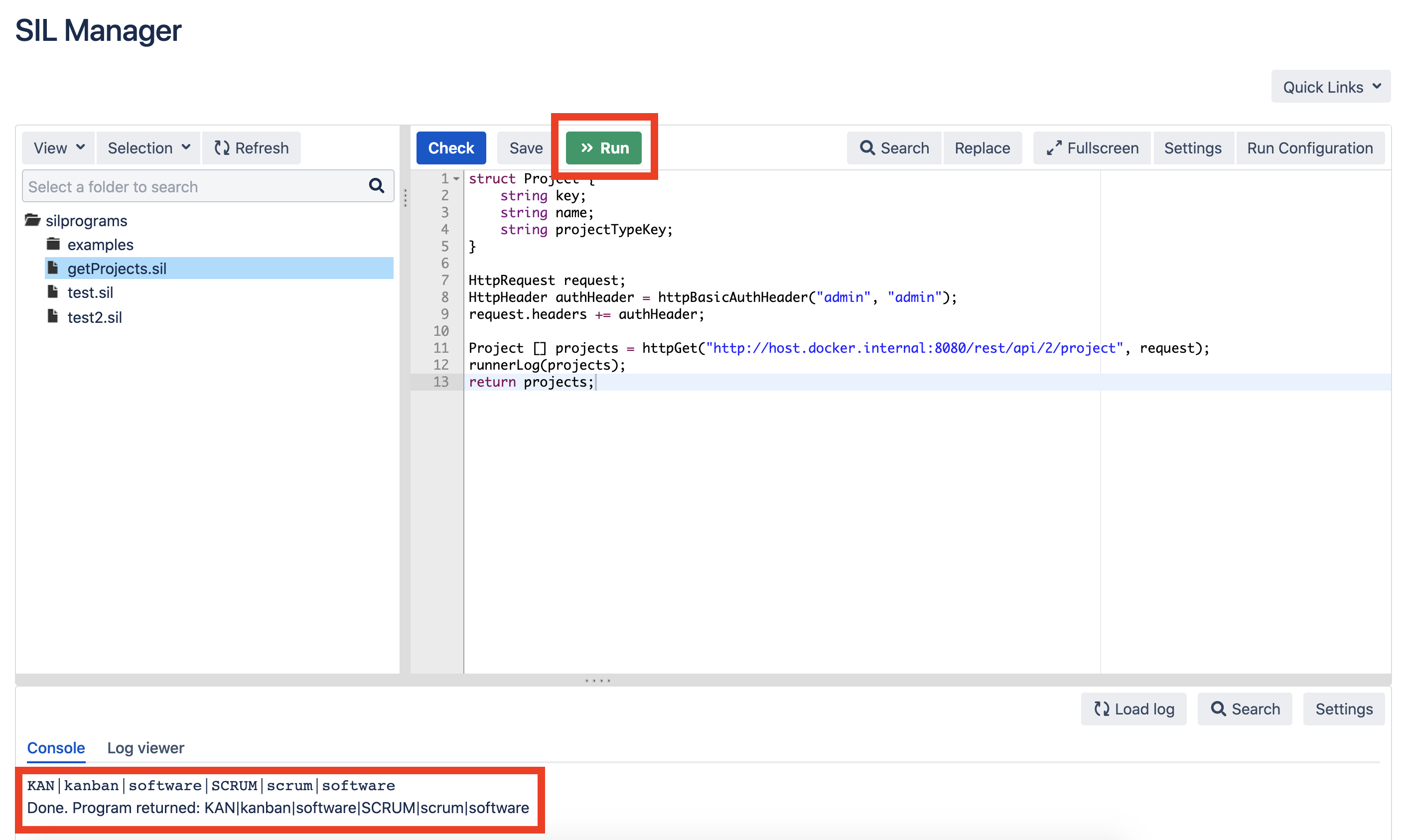

Create a file called getProjects.sil and paste this code into this file:
struct Project {
string key;
string name;
string projectTypeKey;
HttpRequest request;
HttpHeader authHeader = httpBasicAuthHeader("admin", "admin");
request.headers += authHeader;
Project [] projects = httpGet("http://host.docker.internal:8080/rest/api/2/project", request);
runnerLog(projects);
return projects;Change http://host.docker.internal:8080/ to you Jira instance.
Run the script to check that the data are fetched from your Jira instance:

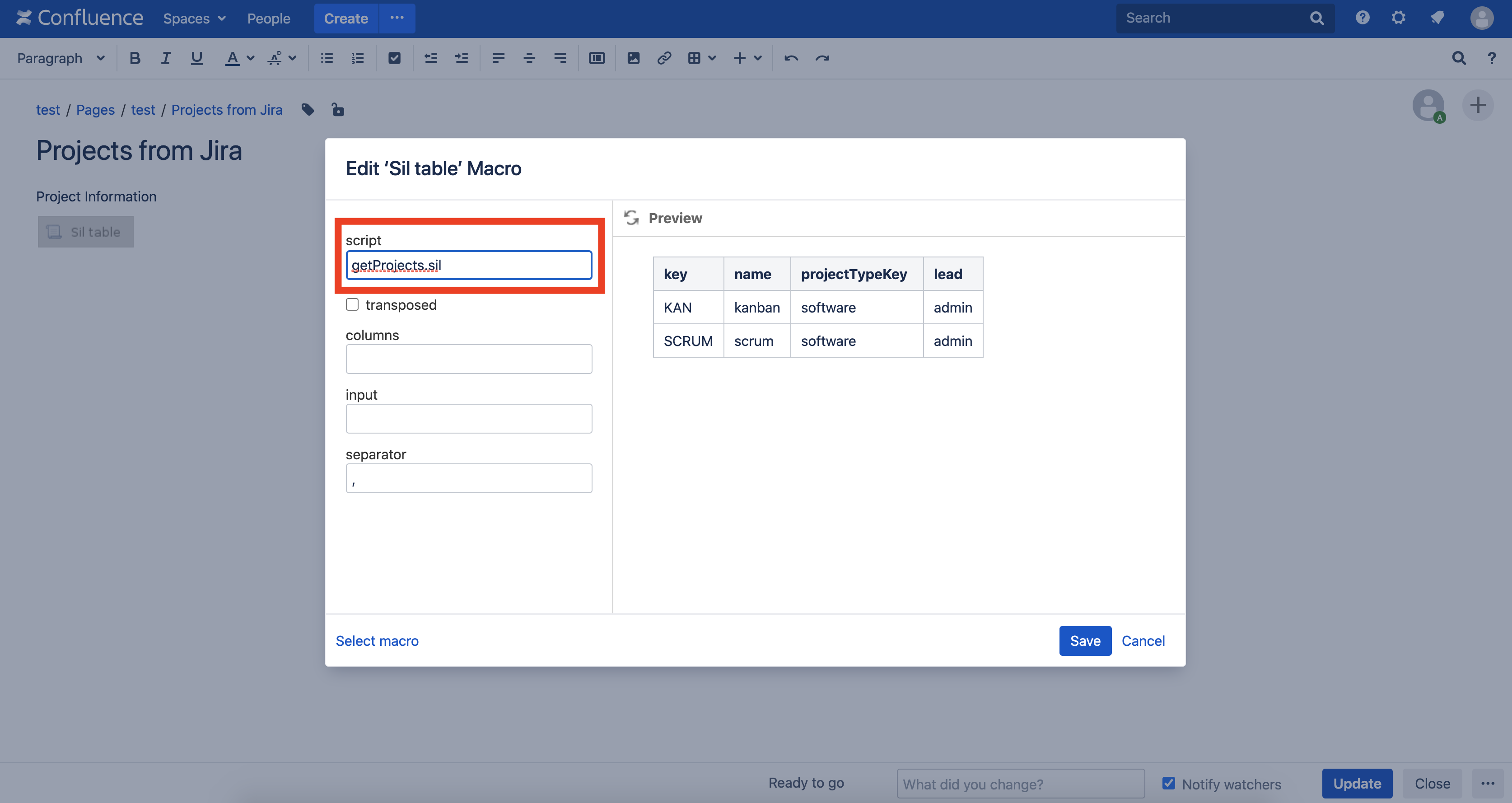

Create a Confluence page
Now create a Confluence page with the SIL table macro. Set getProjects.sil for the script field:

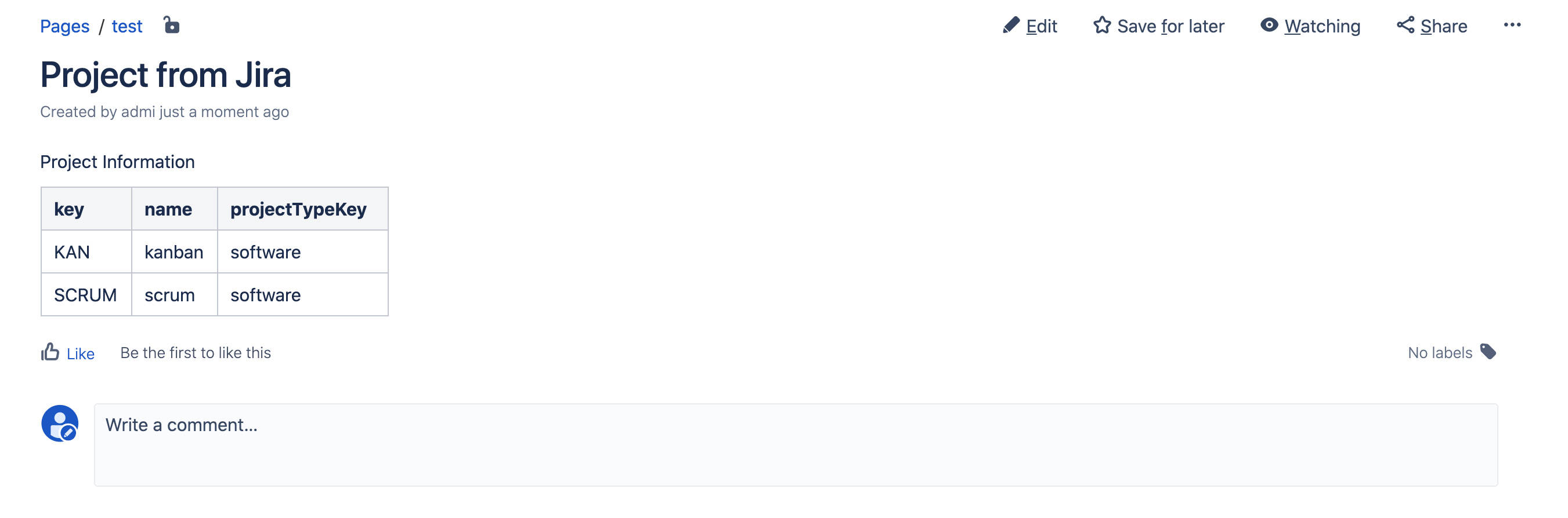

Publish the page and you will see the table:

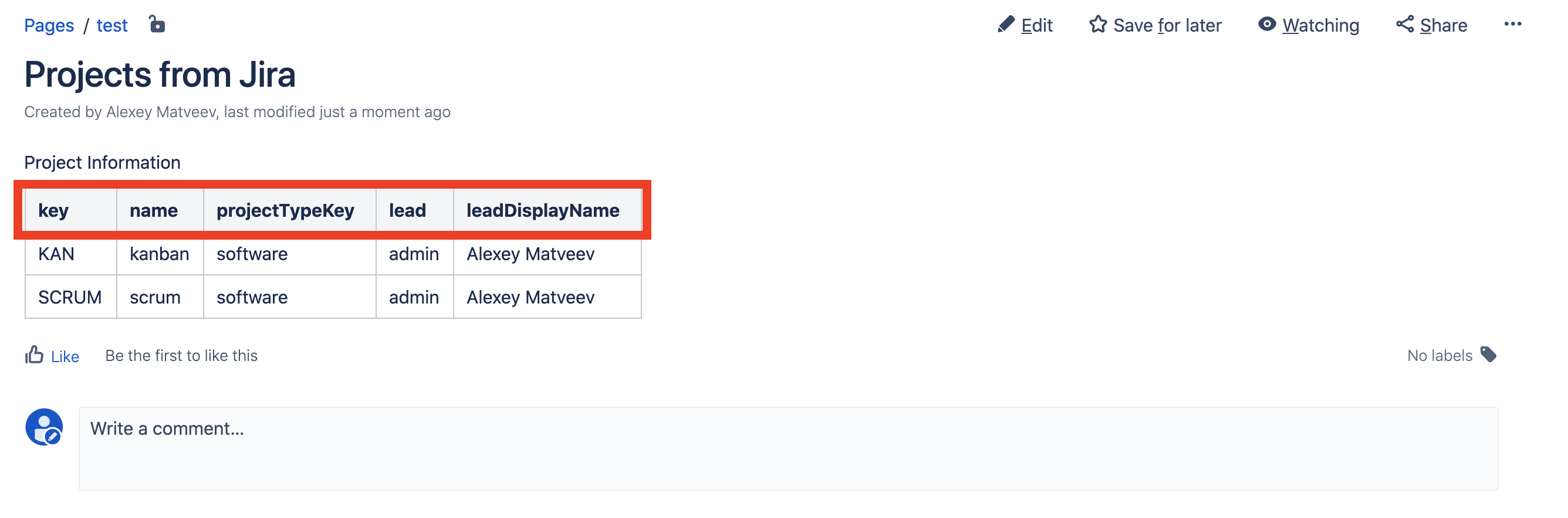

return tableRows;Now refresh the Projects from Jira page and you will see two new columns with the project lead information:

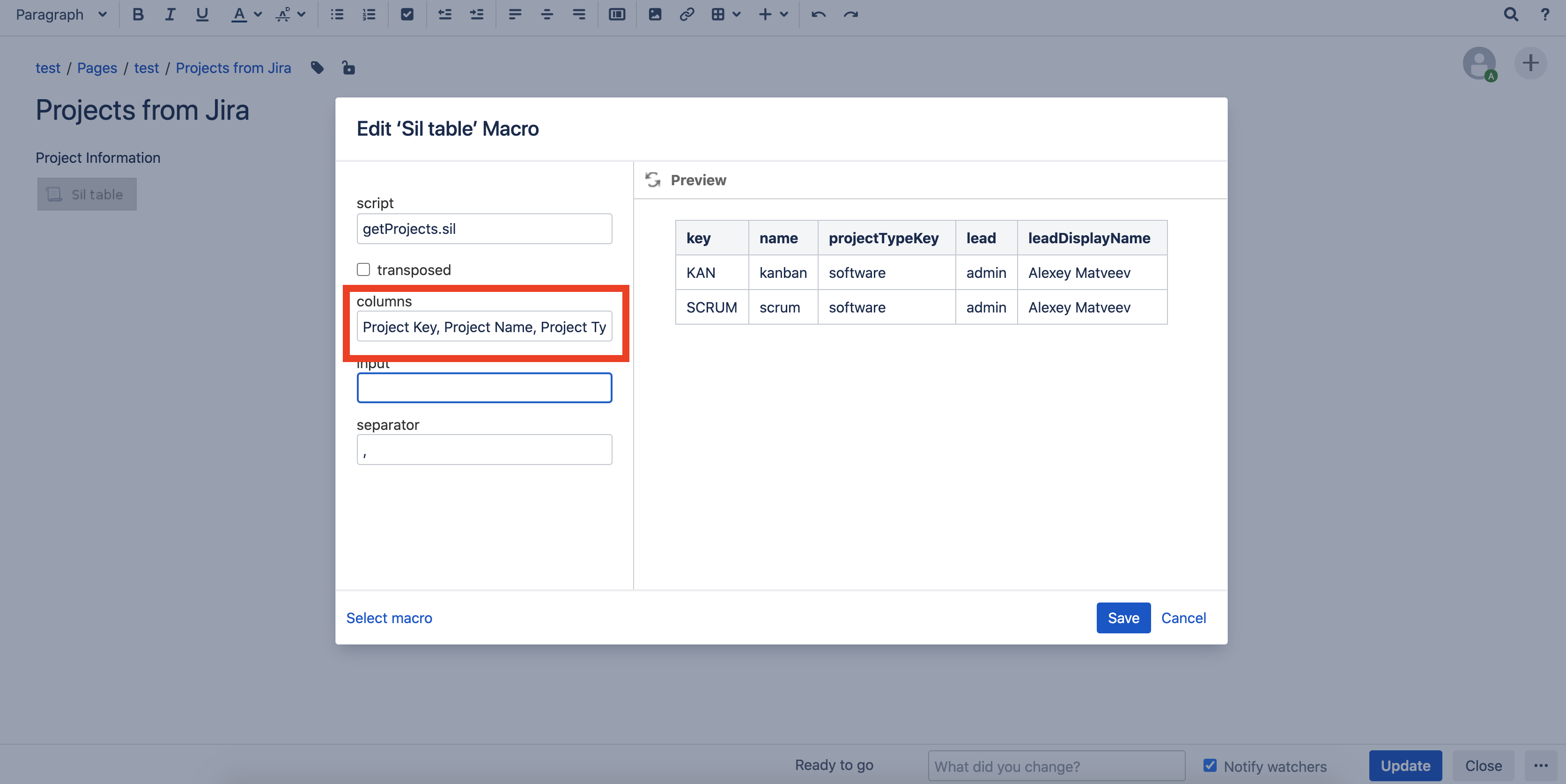

But the names of the columns do not look clean. Let's give the columns more meaningful names.
Edit the page, Edit the SIL table macro and enter "Project Key, Project Name, Project Type, Project Lead, Project Lead Display Name" into the columns field:

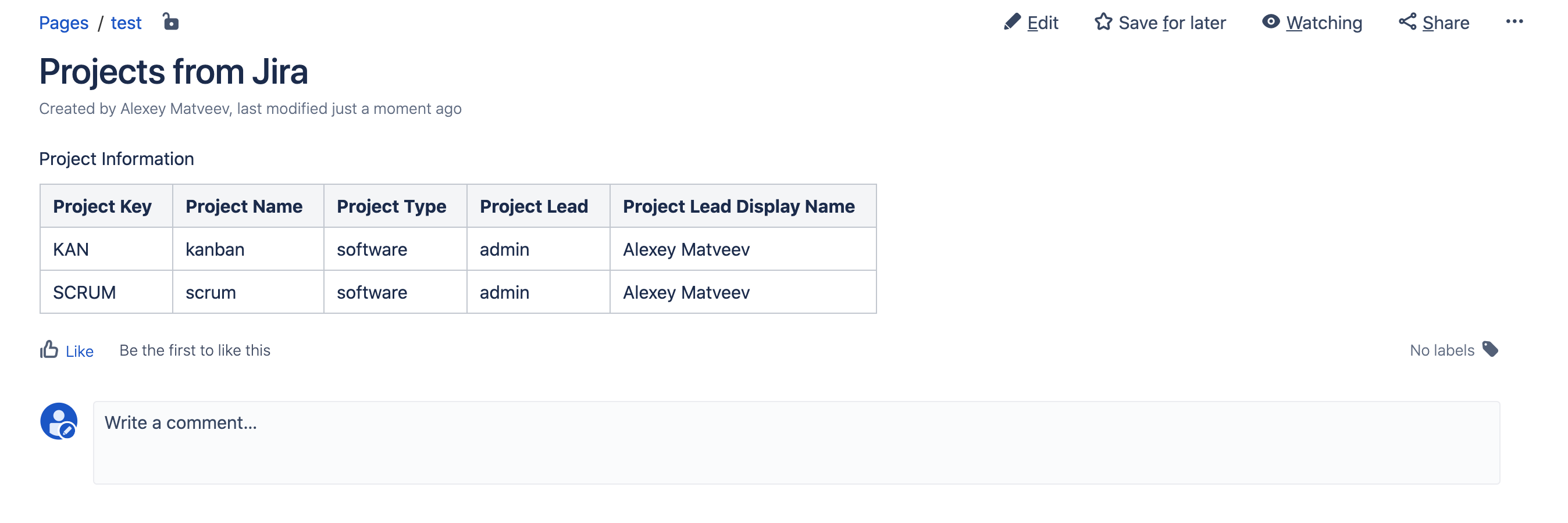

Now save changes and publish the page:
Exactly what we wanted to get!
