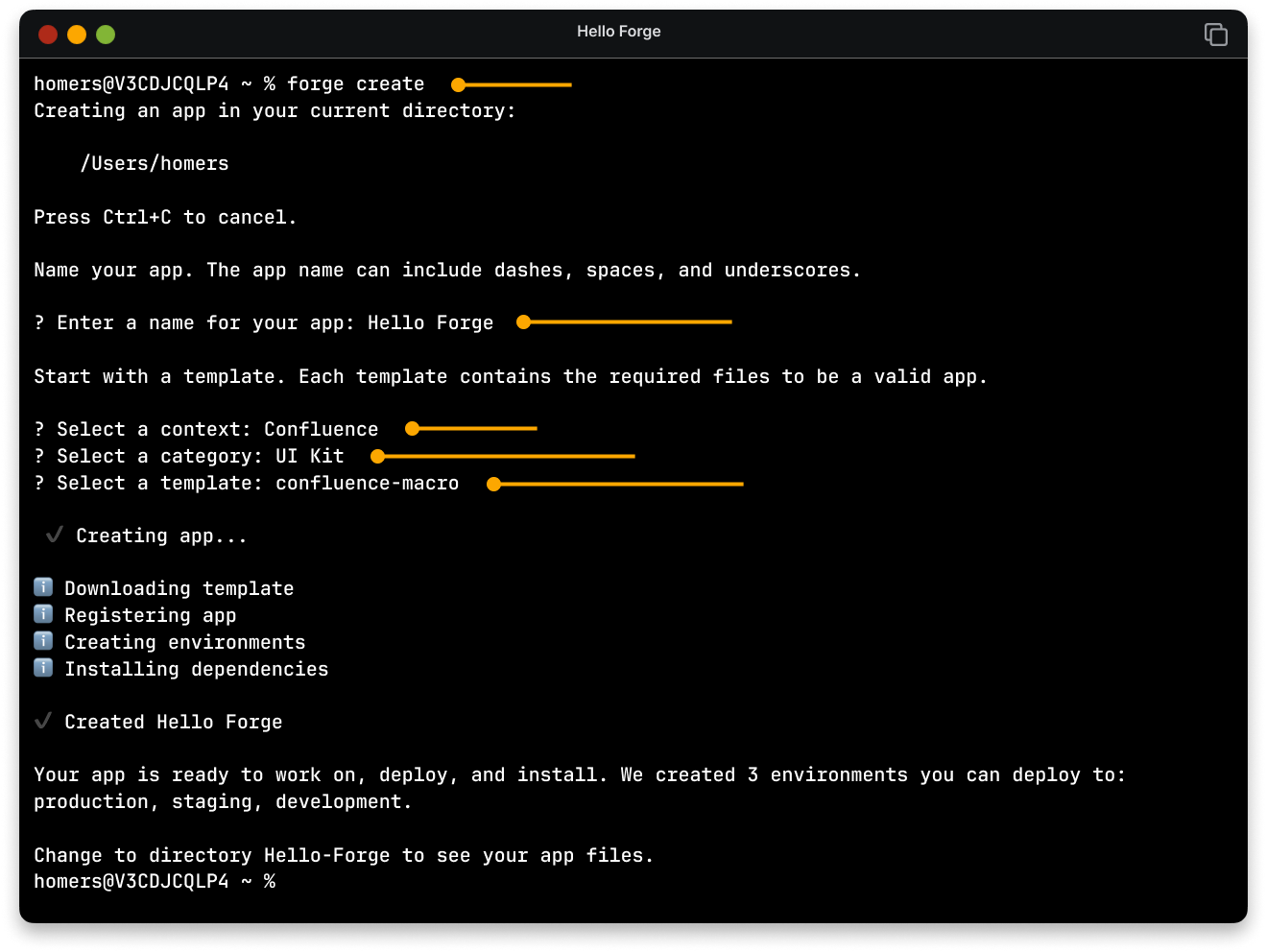

To start building with Forge, you first need to create a base file structure locally as a scaffolding for your app. This is done using the command in the Forge CLI: forge create.
When you run the Forge create command, Forge will walk you through a short interactive setup, prompting you with a few questions about your app.
👇Click the icons below to view the process to create the app.
CLI screenshot with indicators next to various steps of the forge create process.
When you run the forge create command, several key setup tasks are automatically handled in the background to get your app ready for development.
During the create process, Forge:
  1. Downloads your app by generating a new local folder and setting up the necessary file structure. This includes key files like the manifest.yml and a starter template based on the context and category you selected, such as UI Kit, giving you a working code base to start from.
  2. Registers your app by assigning it a unique identifier within the Forge platform, which allows you to manage, deploy, and track it.
  3. Creates your app’s environments: development, staging, and production.
  4. Installs required dependencies for the app to run properly, including any libraries or packages used in the template.

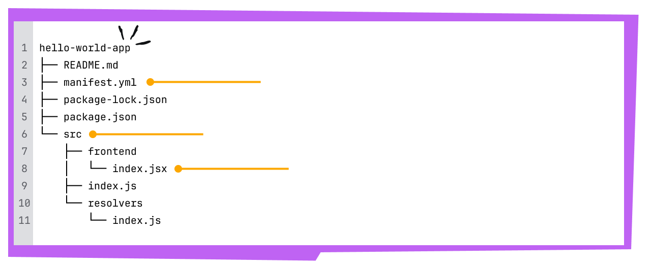

Examine the project’s file structure
After creating your app, the next step is to develop it. This is where you define what your app does and how it behaves. Forge create generates a new app directory locally where it downloads a project structure based on the template you selected. This folder contains everything you need to start building and customizing your Forge app.
Now that your Forge app is created, the development process involves editing a few key files to control how the app looks, behaves, and interacts with Atlassian apps. You'll be editing these files locally in your code editor.
👇 Click the icons below to learn more about what is found in the project folder.
Illustration showing the Forge project structure.
You may see other files within the folder, such as package.json or .gitignore, but we won’t be covering these in detail.
