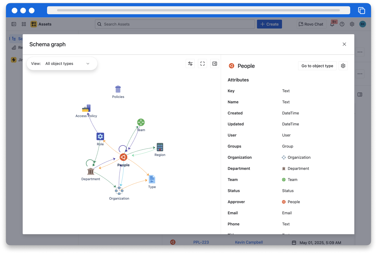

Use Assets' graph views
Assets' graph views enable you to visualize the connections between object types. It's a convenient way to get a comprehensive overview of all object type references.
Graph views are available for the entire object schema, for an individual object type, and also for an individual object.
👇This is an example of an object schema graph.
An object schema is shown in the graph view showing how object types are connected.

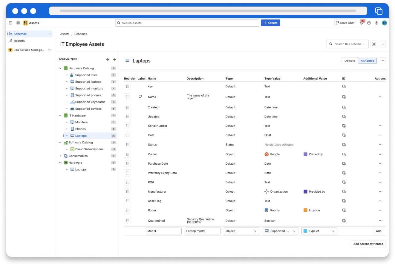

👇Here's the Laptops object type and its Model attribute.
The Laptop object type screen. The Attributes tab is selected.

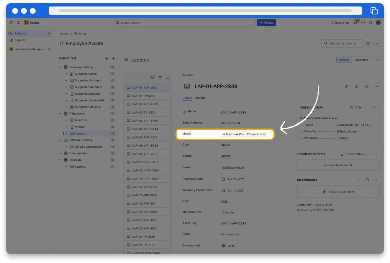

👇 In this example, Model is set to MacBook Pro - 13 Space Gray, which is an object of type Laptops.
The Laptop object type screen. The Objects tab is selected. The computer model, Macbook Pro, is highlighted.

Creating object references
Object type references are created by using attributes of type Object. You can create as many references as you like.
👉 For example: The Model attribute is of type Object, and its Type Value points to the Supported Laptops object type. This is all you need to configure a connection between the Laptops to Supported Laptops object types.
In this example, we use Type of to reference another object, but you can specify a different reference type, which can be helpful when configuring fields and advanced searches.
When a new object of type Laptops is created, the value of the Model attribute is selected from a list of Supported Laptops objects. Object names populate the pick list of the Model attribute.
👇You can create a reference to an object by adding an attribute of type Object.
The IT Employee schema is shown with the Laptops object selected in the Attribute view. A new attribute, Laptop Model, is being added to the object attributes.

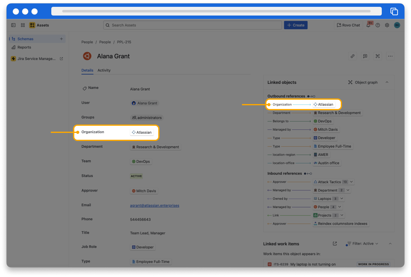

It's also possible to reference objects in a different object schema. To do this, you must enable the setting Allow others to select objects from this schema. To do this you must have a Assets User or Assets Admin role.
👉 For example: If an HR schema contains information about all employees, an ITSM schema can reference the employee objects in the HR schema to assign an employee ownership of a computer.
👇Click the icons below to explore how an attribute is also an outbound reference.
A screenshot showing Alana Grant's information in the detail view in Assets. The Organization in the detail view and Outbound references is highlighted.
