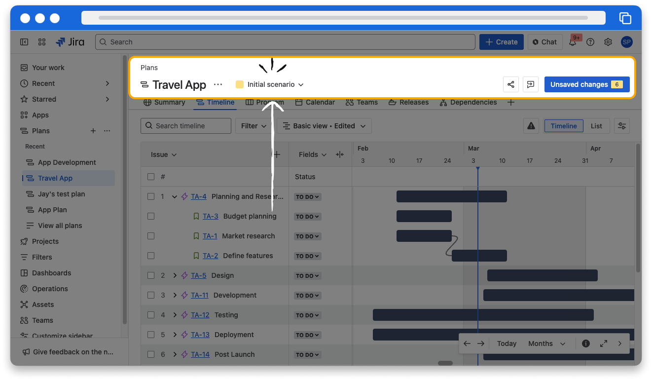

  7. In the sidebar, click Go back (represented by an arrow pointing left) to go back to your plan You should now see the name of a scenario next to the plan name. You can click to switch between scenarios.
The Unsaved changes indicator will change to be the color of the scenario you’re currently viewing. If you make changes to the plan, the changes will only apply to the scenario currently selected.
👇View which scenario you're in next to the plan name.
A Jira screenshot with an arrow pointing to the name of the current scenario.

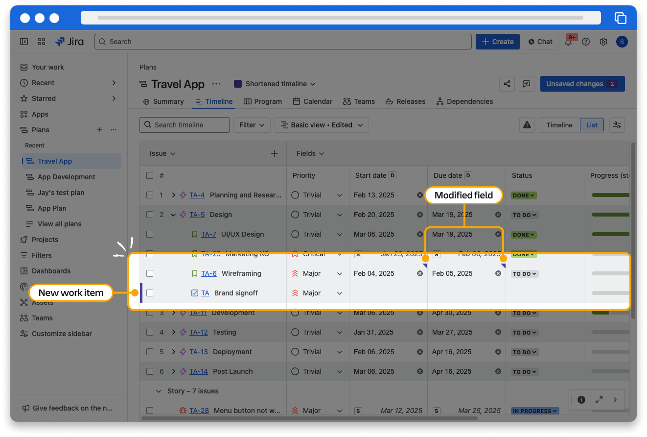

You’ll also see the color of the scenario on the timeline to indicate where changes have been made but not yet reviewed and saved to Jira.
👇You can see indicators of the unsaved changes in your scenarios on any visible fields.
A Jira scenario displays a table of work items. Triangle markers are visible by two dates and and a rectangle appears next to a new work item to identify unsaved changes in a scenario.
