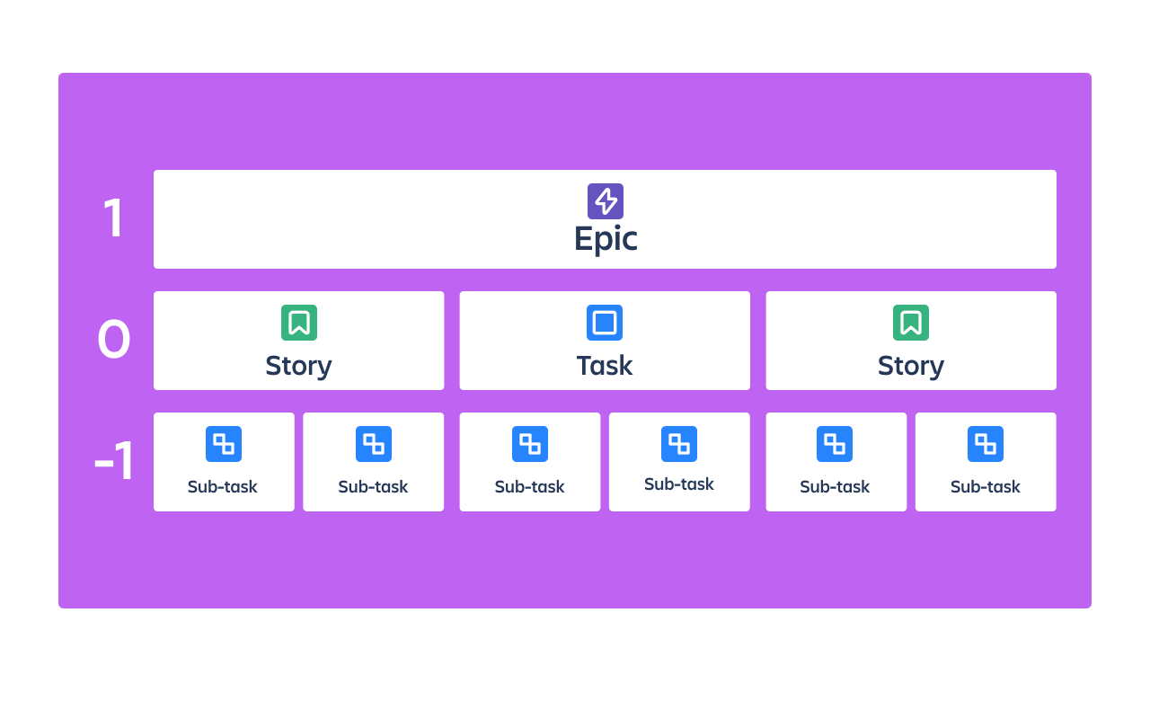

The work type hierarchy controls how work items interact with each other across Jira. It applies to all work, regardless of their space type or work type scheme. The default configuration is:
1. Epic (the Epic work type)
0. Story (all standard work types, like Story and Task)
-1. Subtask (all Sub-task work types)
This means that an epic can be the parent of standard work. Standard work items can be the parent of sub-tasks. But, a sub-task can’t be the parent of anything. Standard work items can’t be the parent of an epic or other standard work.
👇This is the default work type hierarchy for Jira.
Diagram of the issue type hierarchy. At the highest level, level one, is the epic. Under the epic, at level zero, are standard issue types: Story and Task. Under these issue types, at level minus one, are Sub-tasks. These are the lowest level of the hierarchy.
