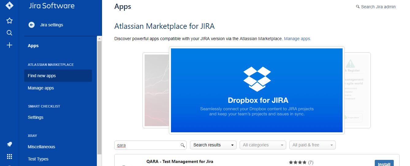

- Login as the Administrator to JIRA Cloud and select "JIRA settings"
- Click on the tab “Find new add-ons”
- Once you are on the "Find new add-ons" page, search for "QARA ".
- Click on the "Free trial" link on the right side of the QARA listing. The QARAJ Cloud add-on will be installed and activated on your system.

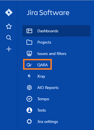

In order to ensure everything is fine, make sure you can see the "Tests" menu in the top level navigation bar, as shown in the screenshot below.

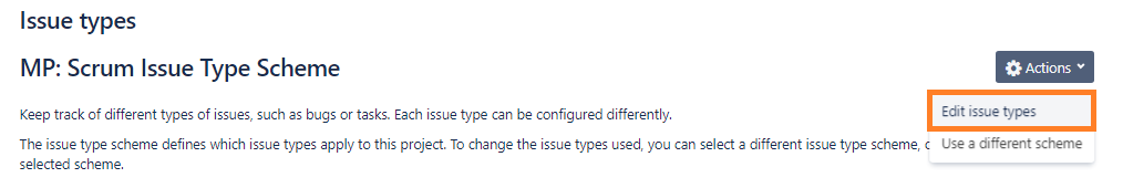

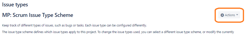

- Click on Project Settings >>> Issue types >>> Action >>> Edit Issue types.
- After clicking on Issue Types, click on the Admin button as shown in the screenshot below.
It gives you 2 options – Edit Issue Types and Use a Different Scheme, as shown below.

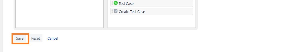

- Drag “Test case” Issue type from “Available Issue Type” table & Drop it in “Issue Types for Current Scheme”.
- Click on “Save” button, as shown below.
