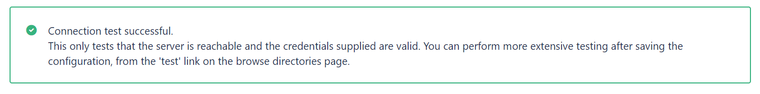

I'm able to connect to the AD server from Jira server on port 389 , also When I test the LDAP connection in Jira web interface it says ok , it says not all tests are performed though
