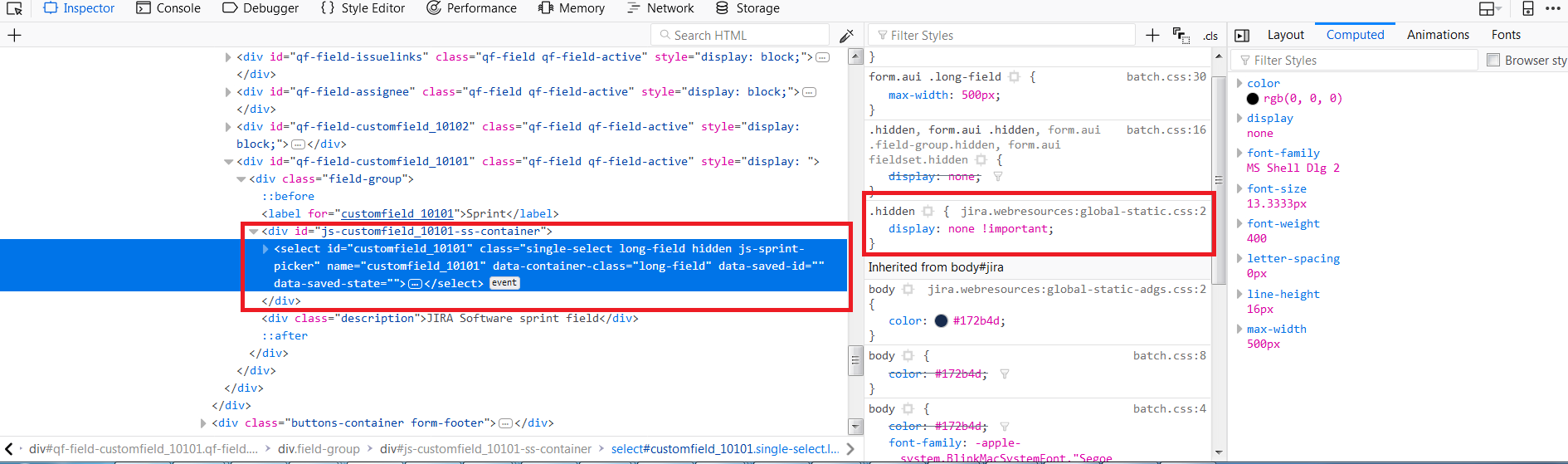

We are using following code to bring Jira's creation dialog. All the fields are working fine except "Sprint " field. It supposed to show a combo to choose but it is not showing anything to choose.
var issueForm = JIRA.Forms.createCreateIssueForm({pid:${projectId}});
var dialog = issueForm.asDialog({windowTitle: 'Create Issue'});
dialog.show();
This is what I got
It is a select field instead of input field and also it is hidden. I have only imported this in my code
$webResourceManager.requireResource("com.atlassian.jira.jira-quick-edit-plugin:quick-form")
Am I missing anything?
