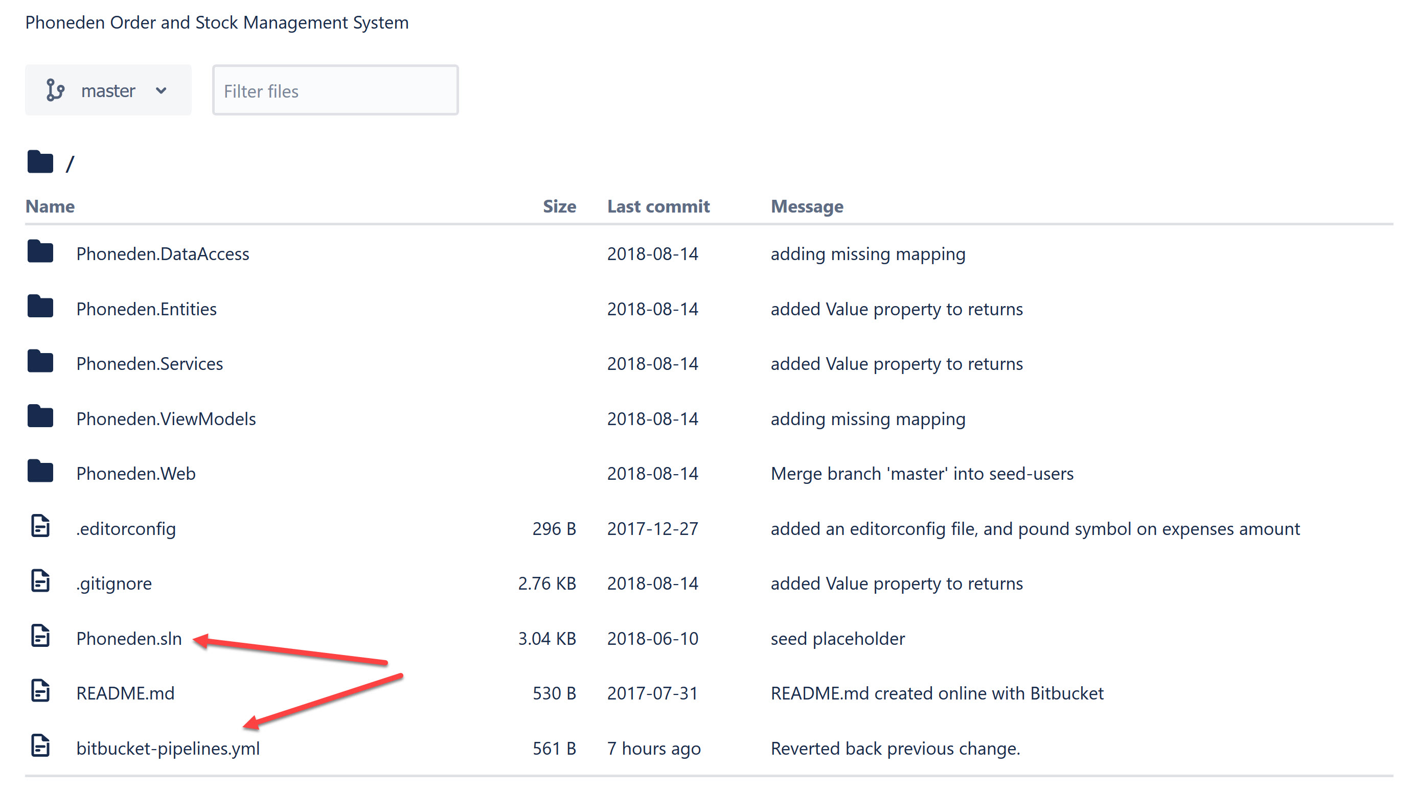

I am new a total n00b to DevOps, but I have heard that BitBucket's pipline feature makes things super easy, so I thought I would try it.
I have created the bitbucket-pipelines.yml file at the root my repository.
But I am getting an error when my pipline runs. The yml file has this:

The message I get when the pipeline fails is:
MSBUILD : error MSB1009: Project file does not exist.
Switch: Phoneden
I assume by Project file, it is talking about the solution file, and you can see from my screenshot that it does exist!
I'm confused. Any help would be greatly appreciated.
