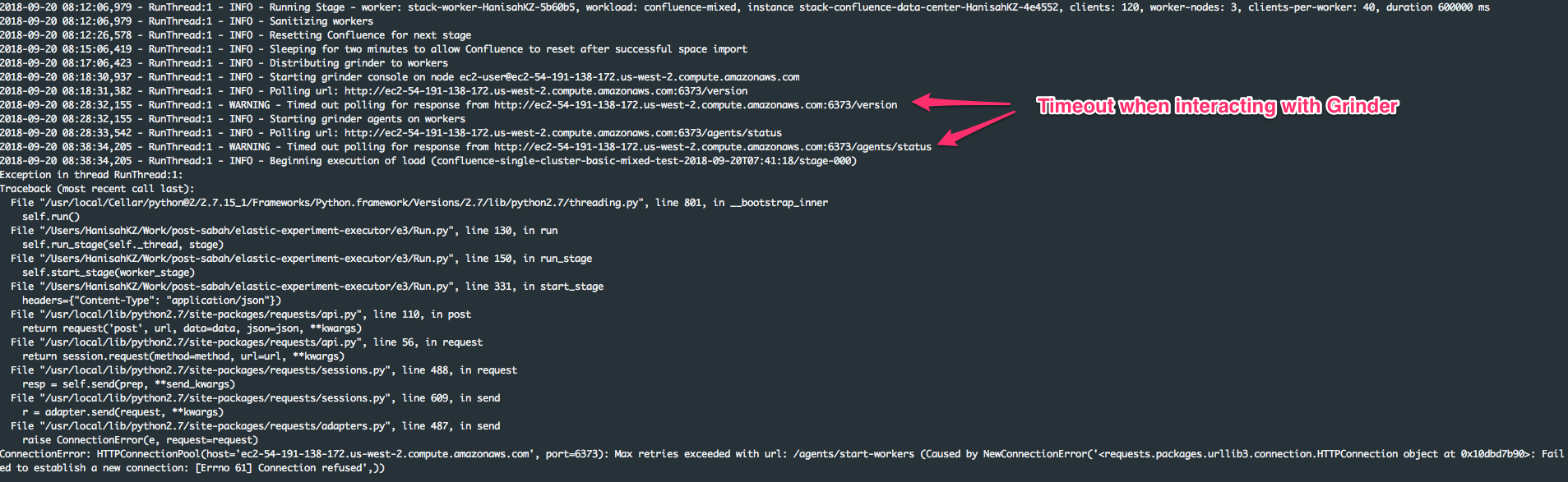

But using the latest version in master (last commit: 65a71fa), I failed to perform the Run phase and eventually Gather and Analyze phases since they are dependent on the Run phase. The error:
Not sure if this is relevant, but I found another question where the poster attached an error that is similar to the one attached here. Although the code error is different (mine is Errno 61, and the poster is Errno 111), it seems to fail at the same part of the code i.e. the Run script. Note that the poster is using E3 for Bitbucket.

I'm suspecting there could be an issue on Grinder being misconfigured that's preventing Grinder from being able to execute the load testing. The error seems to imply that the Grinder console failed to be started.
