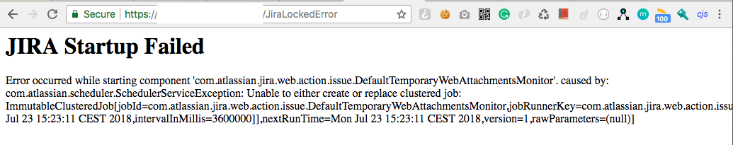

Update from 7.1.4 to 7.2.15 - After running the installer and startup the instance the instance failed to start up with this error message:
Here an excerpt from the "logs/catalina.out" Logfile:

To solve this I tried the following things (found in this three articles)
- https://community.atlassian.com/t5/Jira-Core-questions/JIRA-Startup-Failed-Unable-to-either-create-or-replace-clustered/qaq-p/686280
- https://community.atlassian.com/t5/Jira-Software-questions/Unable-to-start-JIRA/qaq-p/726633
-https://confluence.atlassian.com/jirakb/troubleshooting-jira-startup-failed-error-394464512.html
I run these to commands on our database:
jiradb=# reindex database "jiradb";
jiradb=# vacuum analyze public.clusteredjob
This did not work, then I delete the "clustereddjob" table complete, also this didn't work. (There were no duplicate rows in this table)
Also, I tried:
- Increasing JIRA Memory.
- Start Jira in Safe Mode (all plugins disabled)
- Plugins require more time to startup (add 30sec wait)
-Datlassian.plugins.enable.wait=300
Can you help me with this problem?
