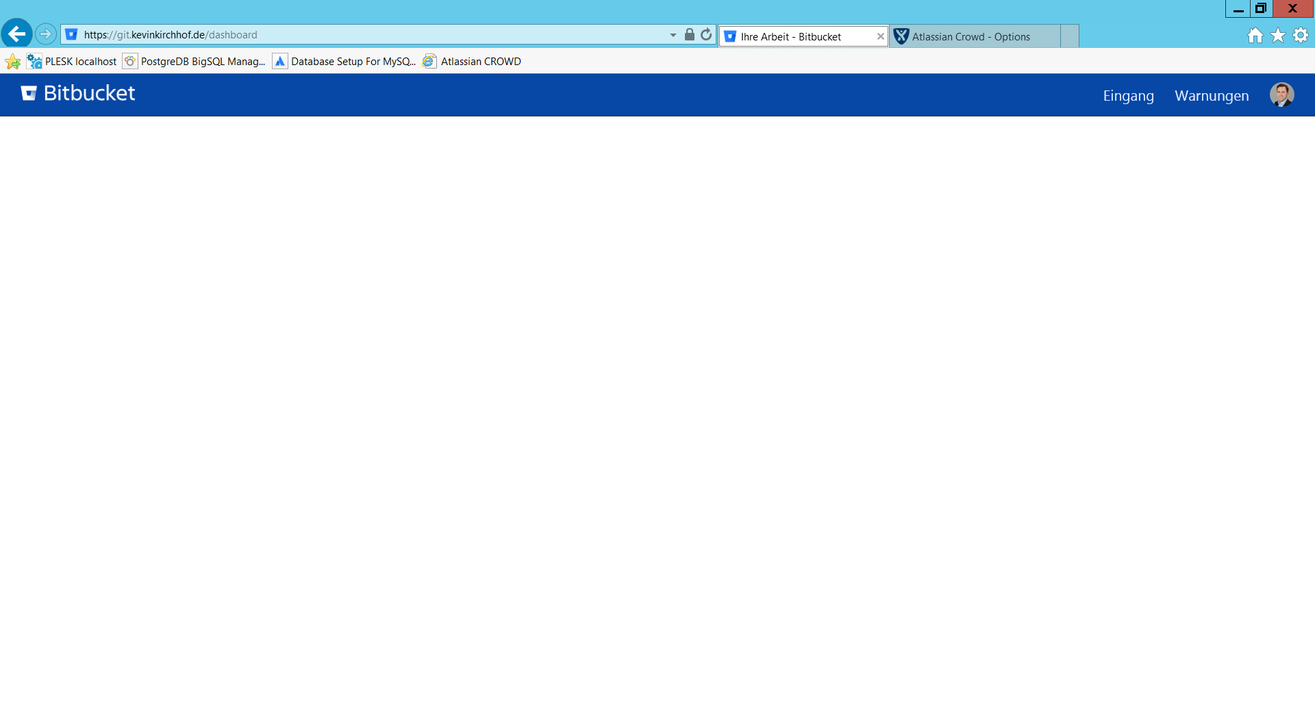

In addition, if I try to access Bitbucket on the server itself and login, the login works though the domain is redirected form the local address (localhost) to the proxy name address. But even if the login works, no content is displayed in Bitbucket: I can only view my logon and the "headline" of the Bitbucket website, like:
