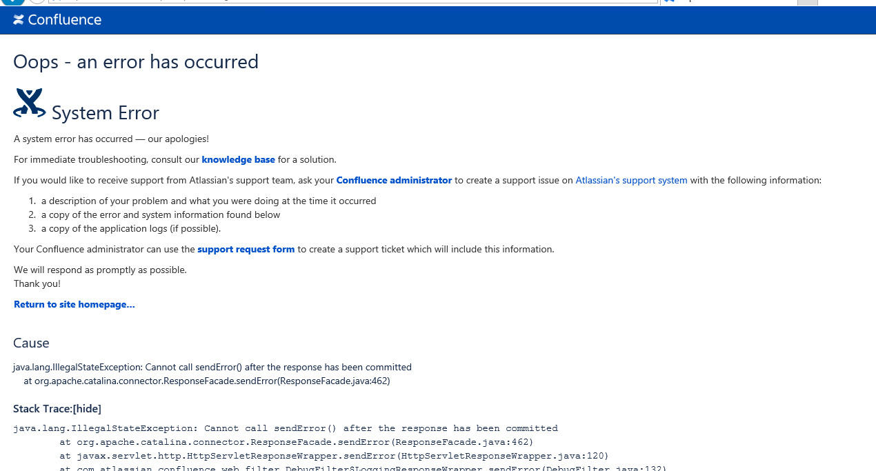

50% of the time, it loads with an error:

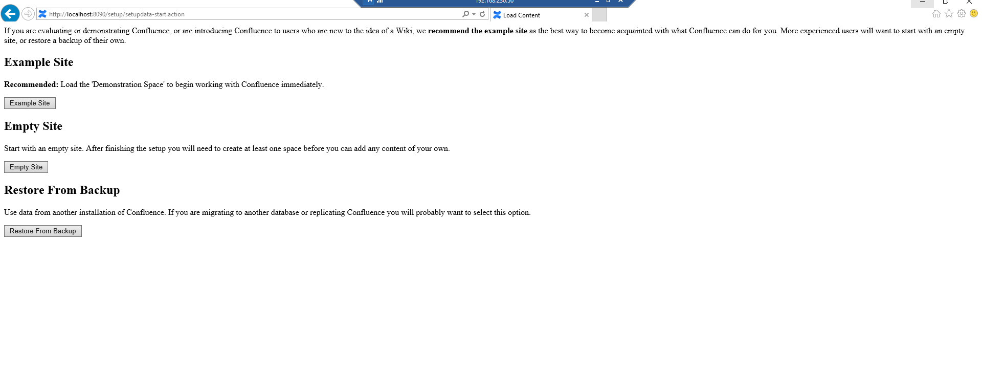

the rest of the time, I am able to get past this first stage, supply DB credentials (which pass test) and I can verify it creates the database. After a while, it goes to the next page which looks unthemed (I can't remember/not sure if it should be):

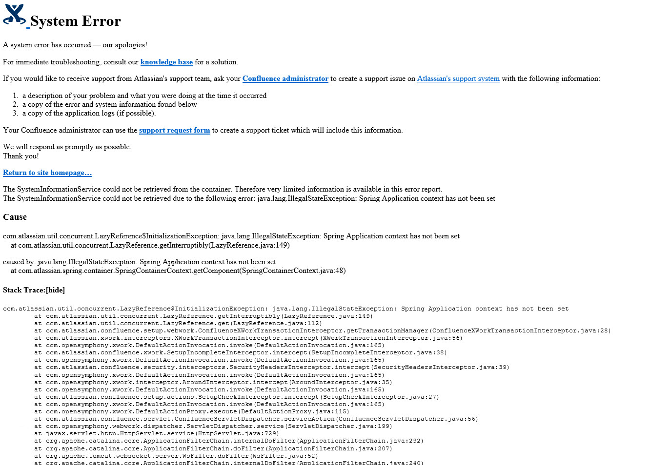

It doesn't matter if I chose Example or Empty site, the next page takes a while, it then asks me to set up authentication and I chose JIRA each time. It then forwards me to this error:
