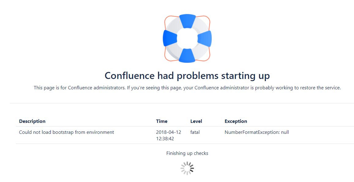

After following the instructions located at https://confluence.atlassian.com/doc/moving-from-data-center-to-server-938042866.html and starting Confluence again, die Web UI shows Confluence had problems starting up (see attached screenshot).
The following output is logged to catalina.out ... but ... was does it tell me?
