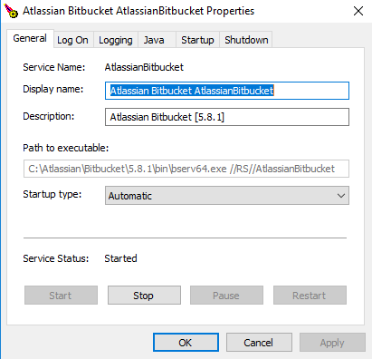

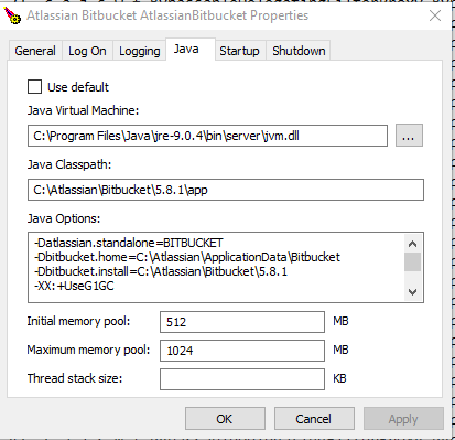

Hello,
I am trialing Bitbucket server edition on my Windows 10 machine but having problems starting the web site (somewhere after it says initializing hibernate if fails). I have installed the 64bit Edition of JRE and have configure the service to use the correct .dll. See below for details. I have tried reinstalling and allocating more memory but nothing has worked so far.

Caused by: java.lang.NoClassDefFoundError: javax/xml/bind/JAXBException
at org.hibernate.boot.spi.XmlMappingBinderAccess.<init>(XmlMappingBinderAccess.java:43)
at org.hibernate.boot.MetadataSources.<init>(MetadataSources.java:87)
at org.springframework.orm.hibernate5.LocalSessionFactoryBean.getMetadataSources(LocalSessionFactoryBean.java:364)
at org.springframework.orm.hibernate5.LocalSessionFactoryBean.afterPropertiesSet(LocalSessionFactoryBean.java:399)
... 5 common frames omitted
Caused by: java.lang.ClassNotFoundException: javax.xml.bind.JAXBException
at java.base/java.net.URLClassLoader.findClass(Unknown Source)
at org.springframework.boot.loader.LaunchedURLClassLoader.loadClass(LaunchedURLClassLoader.java:94)
... 9 common frames omitted
