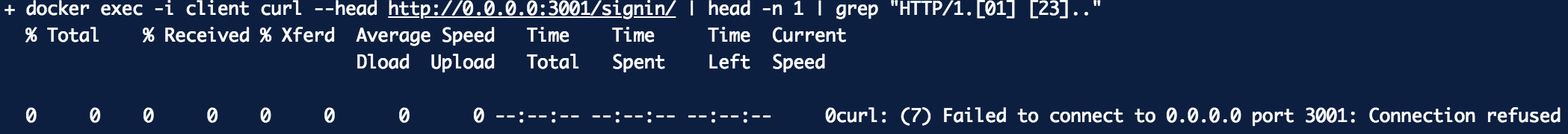

- docker exec -i client curl -I 0.0.0.0:3001/signin/ | head -n 1 | grep "HTTP/1.[01] [23].."

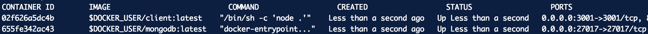

Both container running and now I wanted to check if the website is running inside the container with a curl statement but It's not working. I tried the same commands locally and it works. I also switched already between IP address like 127.0.0.1 and 0.0.0.0 --> both did not work in the pipeline but locally
docker ps output:
OutPut in my Pipeline:
% Total % Received % Xferd Average Speed Time Time Time Current Dload Upload Total Spent Left Speed 0 0 0 0 0 0 0 0 --:--:-- --:--:-- --:--:--
0curl: (7) Failed to connect to 0.0.0.0 port 3001: Connection refused

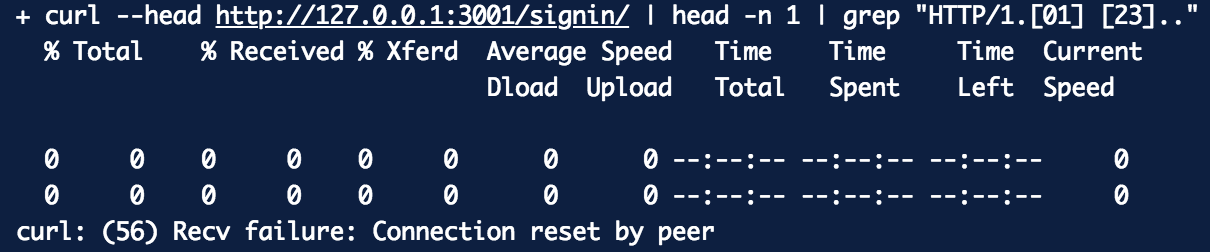

I also tried to execute the curl command directly in the pipeline shell but then I also have an error, but a different one:
curl --head <a href="http://127.0.0.1:3001/signin/" target="_blank" rel="nofollow noopener noreferrer">http://127.0.0.1:3001/signin/</a> | head -n 1 | grep "HTTP/1.[01] [23].." % Total % Received % Xferd Average Speed Time Time Time Current Dload Upload Total Spent Left Speed 0 0 0 0 0 0 0 0 --:--:-- --:--:-- --:--:-- 0 0 0 0 0 0 0 0 0 --:--:-- --:--:-- --:--:-- 0curl: (56) Recv failure: Connection reset by peer
