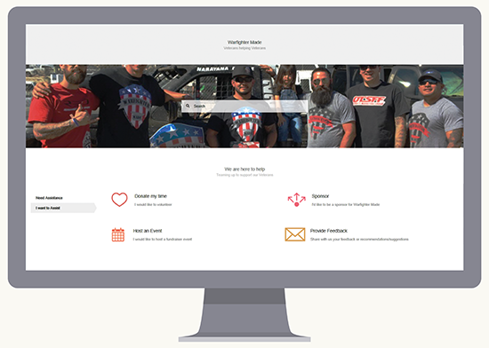

Before and After

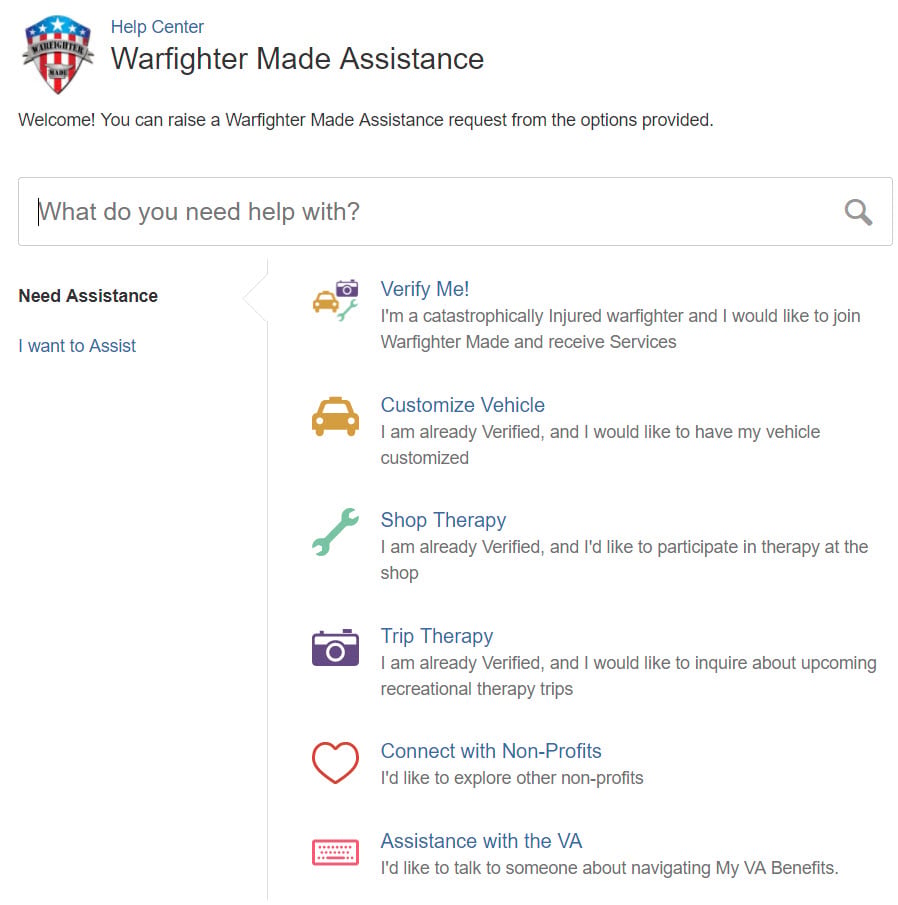

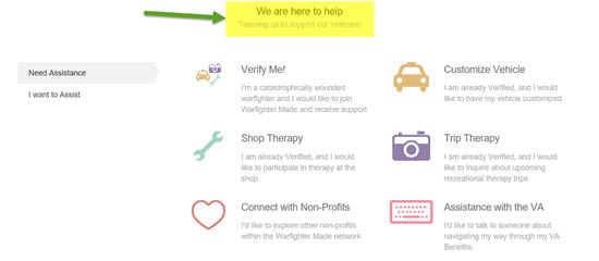

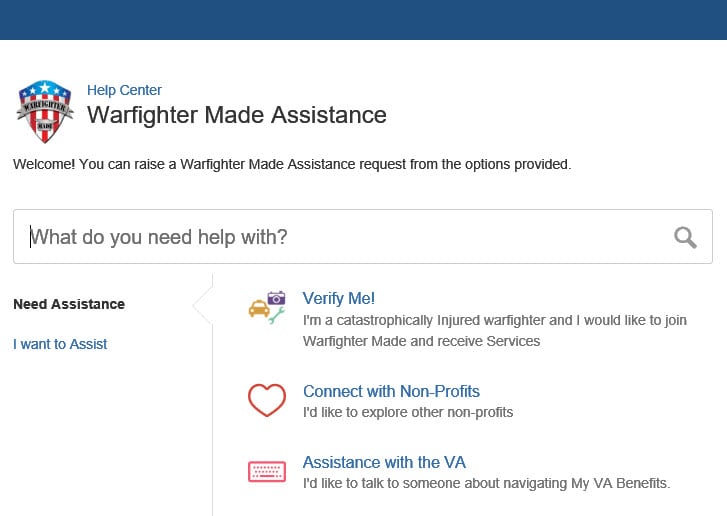

Need Assistance options in the out of the box portal view

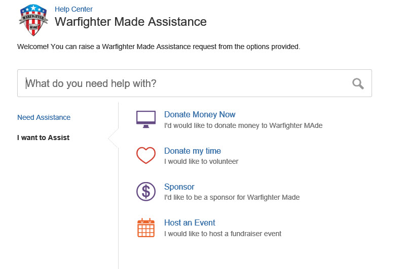

I want to Assist option in the out of the box portal view

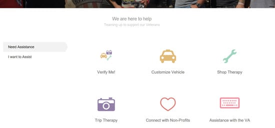

Need Assistance option expanded after verification of the veteran. Once the veteran is verified by Warfighter Made staff the options to Customize Vehicle, Shop Therapy, Trip Therapy and others are activated. (we will explain how we did it in an upcoming blog post)
As you see on the previous screen-captures the user experience out of the box is good enough and it could fulfill any type of need for a self service portal. The challenge for us was that the user will be landing here from a link that we will add to the regular organization website.

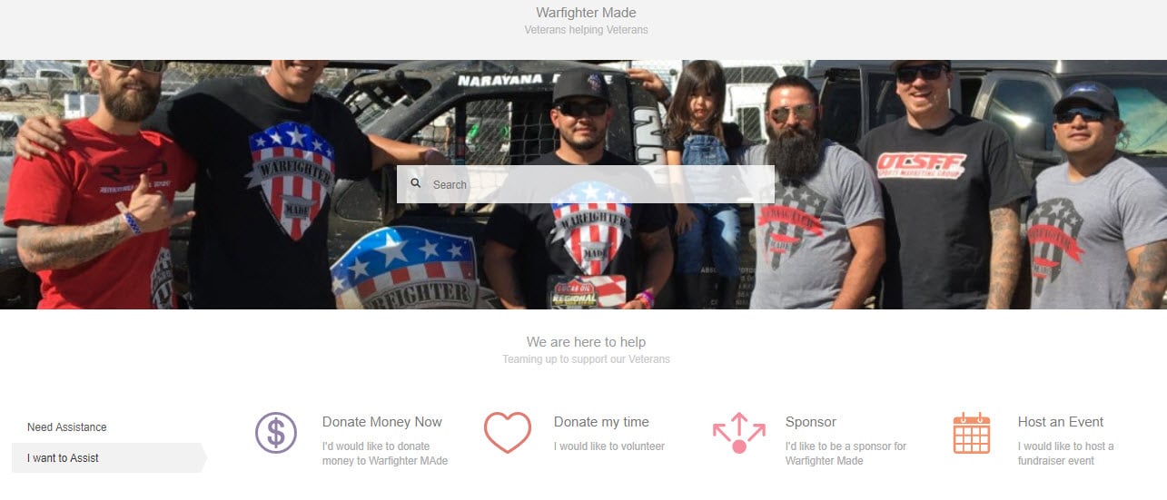

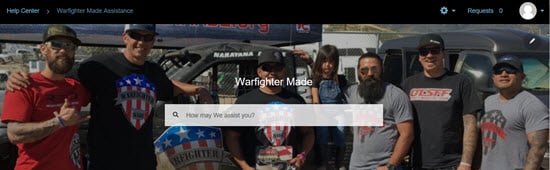

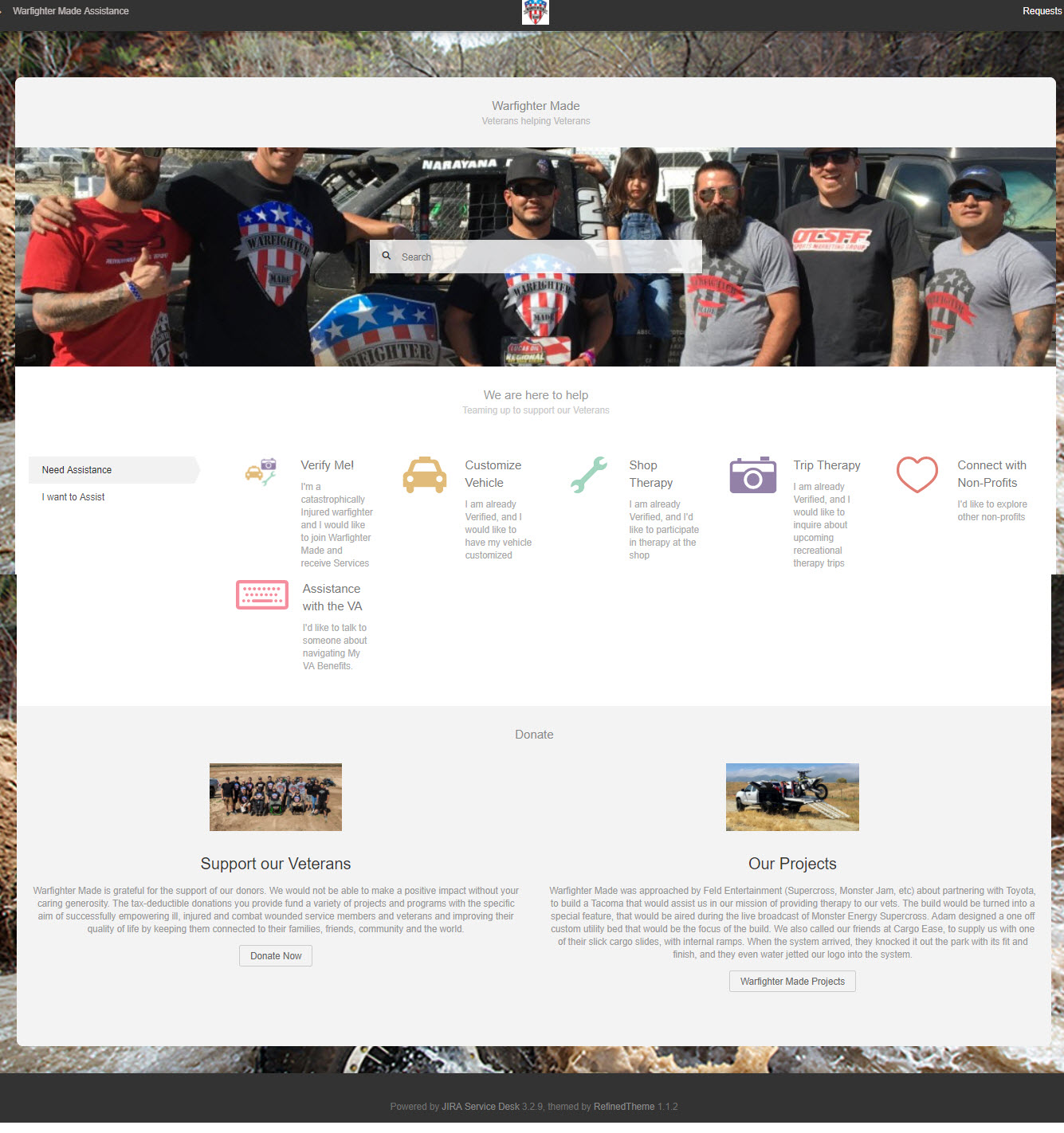

The new branded portal after configuring RefinedWiki theme for Jira Service Desk. Notice on the screen capture the additional modules added for Support our Veterans and Our Projects. This is after the verification of the veteran.
I Want to Assist section with the new header background using the new customized theme.

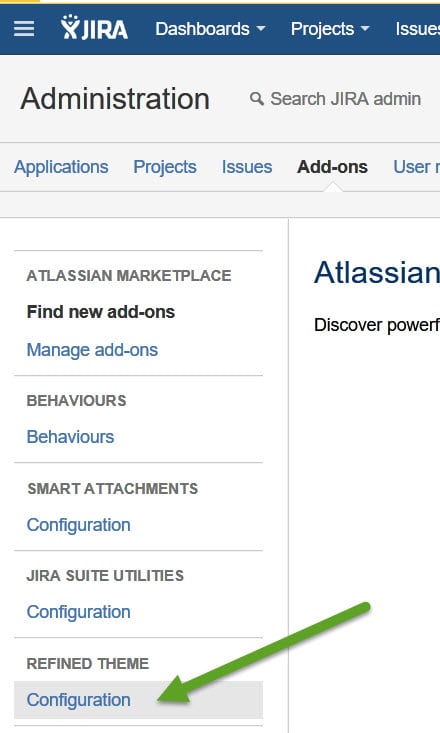

Yep, is that easy, it is really amazing, when you have time crunch, to find an add on that has a straight forward configuration. Kudos to the team behind this product. (Confluence theme requires a little bit more effort to accomplish the same, but it is due to the complexity of the supporting product itself). Let's go behind the scene to explore the configuration of this particular theme.

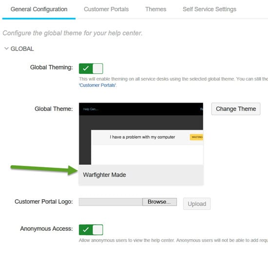

System Administration / Atlassian Marketplace / Add-ons / Refined Theme / Configuration

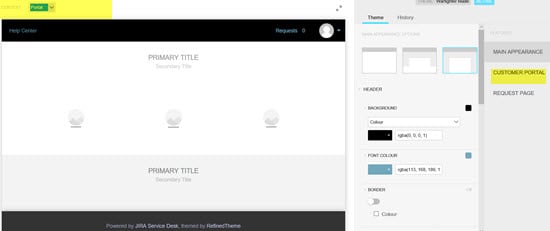

First of all, verify that you have the right Theme selected as global and then work on the theme with the customization and look and feel changes.
Configuring the theme consists on the selection of style, colors and overall layout.

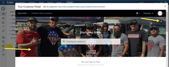

From the actual project you can visit and edit the portal to narrow the theme from the global layout.

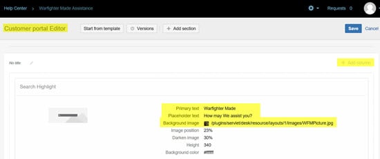

The Customer Portal Editor that is part of the theme for Jira Service Desk allows you to work on the landing page for the user by adding components to the page and modifying the layout of the information. You can start from a template, add sections, split sections and add modules that will contain different type of information.
Portal Editor parameters
Final outcome of the Search Highlight section based on parameters above

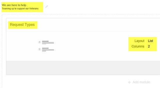

Parameters for the Request Types block
Outcome based on parameters: Layout: List / Columns:2
Different outcome by changing parameters to: Layout:Icons / Columns:3

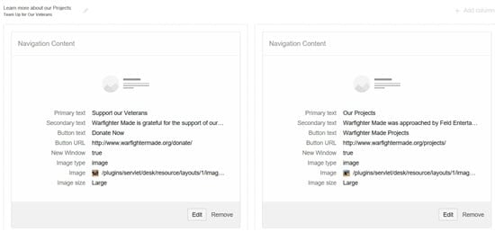

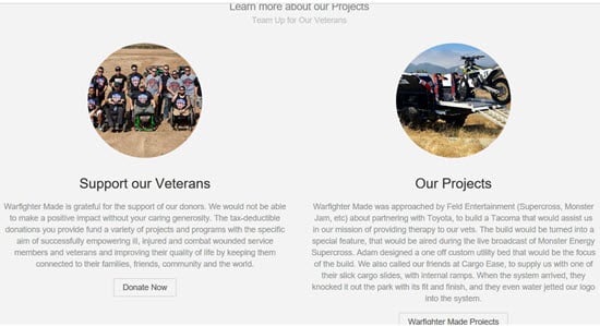

In addition to the regular information for the self service portal, the add-on allows you to add more sections and modules for navigation content. For this particular project I added one section with two columns, one for Donation and other for Projects.
Parameters for the Navigation content modules.
Outcome based on parameters above.
