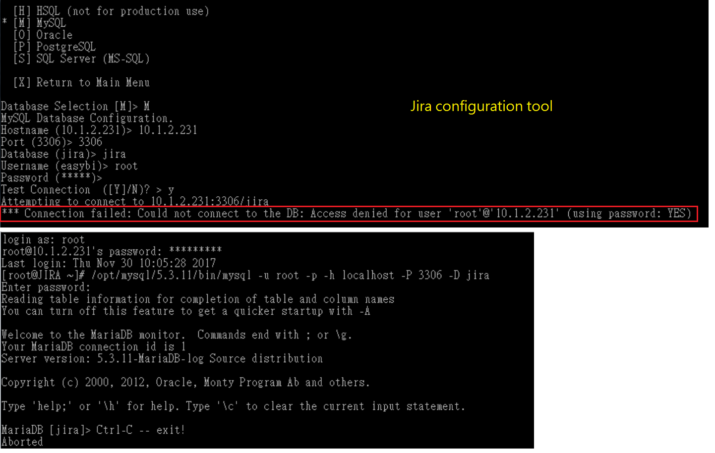

We used system snapshot method to clone a production environment to the other VM server for test/staging purpose. However, we encountered the problem that everything we changed on the cloned server would change to production one. Wondering what config. settings should be changed on the staging environment to avoid this problem. We are using Jira server v6.3.15, BTW.
Besides, we were thinking maybe we can change the database location via Jira configuration tool but we got "Access Denied" error while testing the connection in the last step. However, using mySQL command to do the same thing seems to work. Therefore, we don't know how we can solve the problem. Can anyone advise the correct step when using system snapshot to clone the environment and how to config. the data to the right clone environment instead of still connecting with production one? Thanks.
