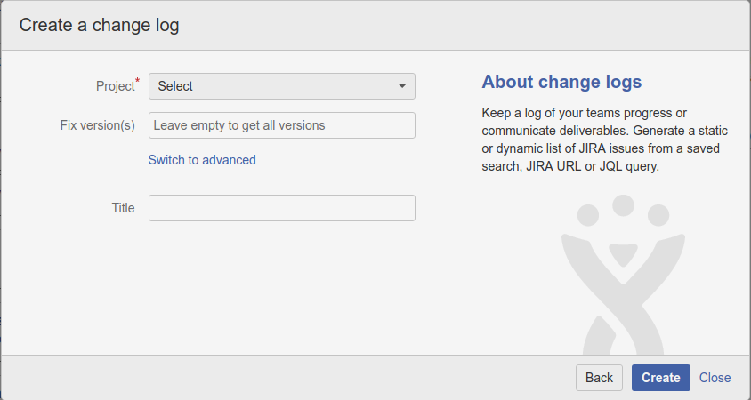

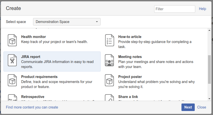

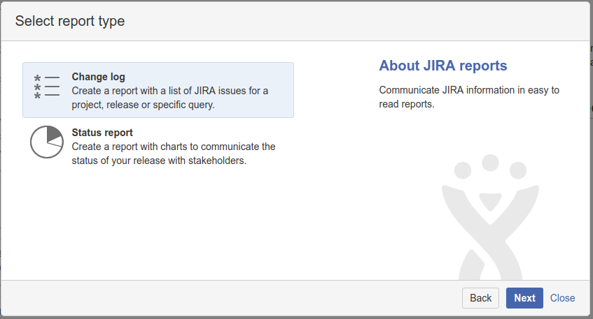

My basic requirement is to customize the flow of jira reporting with confluence software by implementing more filters inside figure “C”.
figure: A
figure: B
figure: C
As we can see in figure “C”, we have only one filter which is “Project” drop box. If we need to add more filtering when creating jira report we need to use “Switch to advanced” link and copy-paste the JIRA query by accessing Jira software side. Without copying query from jira side my requirement is to have more than one drop boxes in figure “C” wizard to filtering. Then it is required to have corresponding filters for each and every drop box to select.

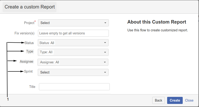

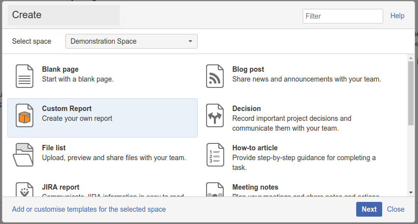

My expectation is something similar to this,
figure: D
figure: E
As you can see figure “E” we basically need to add more filters into dialog wizard. If we can develop this requirement as a confluence plugin for Jira reporting instance it should be allowed user to customize filter titles too which are numbered as 1. Simply we need to filter by “Resolution” without using “Sprint” we will be able to change the “Sprint” to “Resolution” wherever inside the plugin source code. After rebuilding the plugin module it may be appeared with “Resolution” drop box instead of “Sprint” drop box. This should be applied under a new instance such as “Custom Report” as in figure “D”.
When we select a project then it will be getting the corresponding data of Statuses, Types, Assignees and also Sprints to this dialog wizard for filtering according to figure “E” as an example. Finally this customized report should be created and published as same as jira reporting process.
