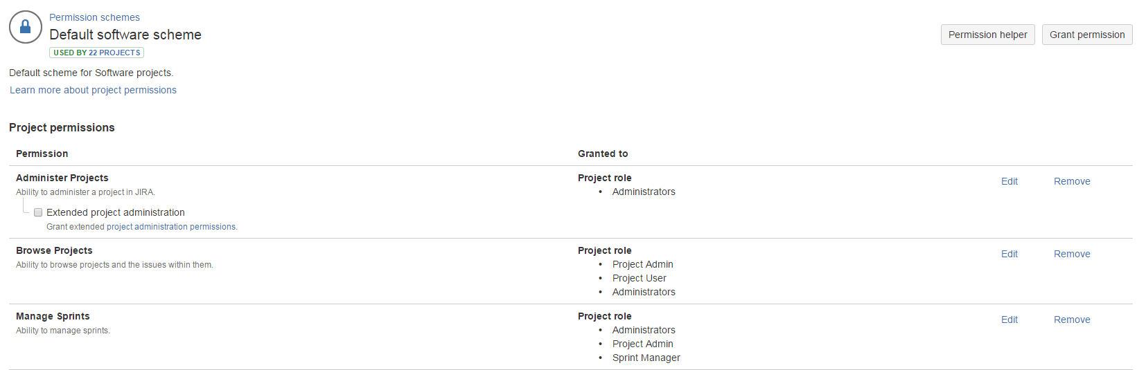

Permission scheme;

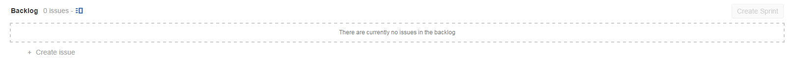

Impersonating the user to see their screen shows the following:

My question is - why are users not able to create sprints though they are given the right level of permissions?
But when I add the users explicitly to the permission scheme, they are able to Manage Sprints.
The documentation suggests to create a new Project Role, but I had no luck with it. I believe this is a bug. Can anyone guide me here?
