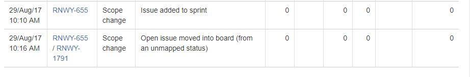

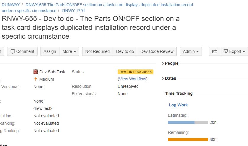

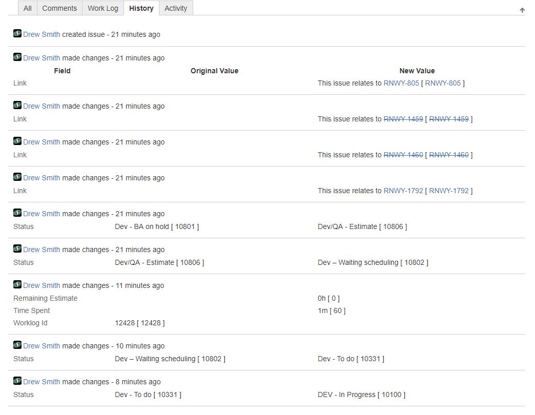

- Setting the Original Estimate - the Original Estimate shows up on the right side in the Time tracking but the Remaining Estimate is not set, there is no entry in the Issue's history and no time is in the Sprint burndown chart. I even tried logging one minute and the Remaining Estimate time did not get set. (the Dev/QA Estimate - Dev-Waiting Scheduling transition in attached images)
- Setting the Remaining Estimate - Remaining Estimate shows up on the right side in the Time tracking, there is no entry in the issue's history and no time is in the Sprint burndown chart. (the Dev-Waiting Scheduling - Dev - To do transition in attached images)
The attached images show the results other than the image for Time Tracking panel on the right side was taken after both transitions were run.
