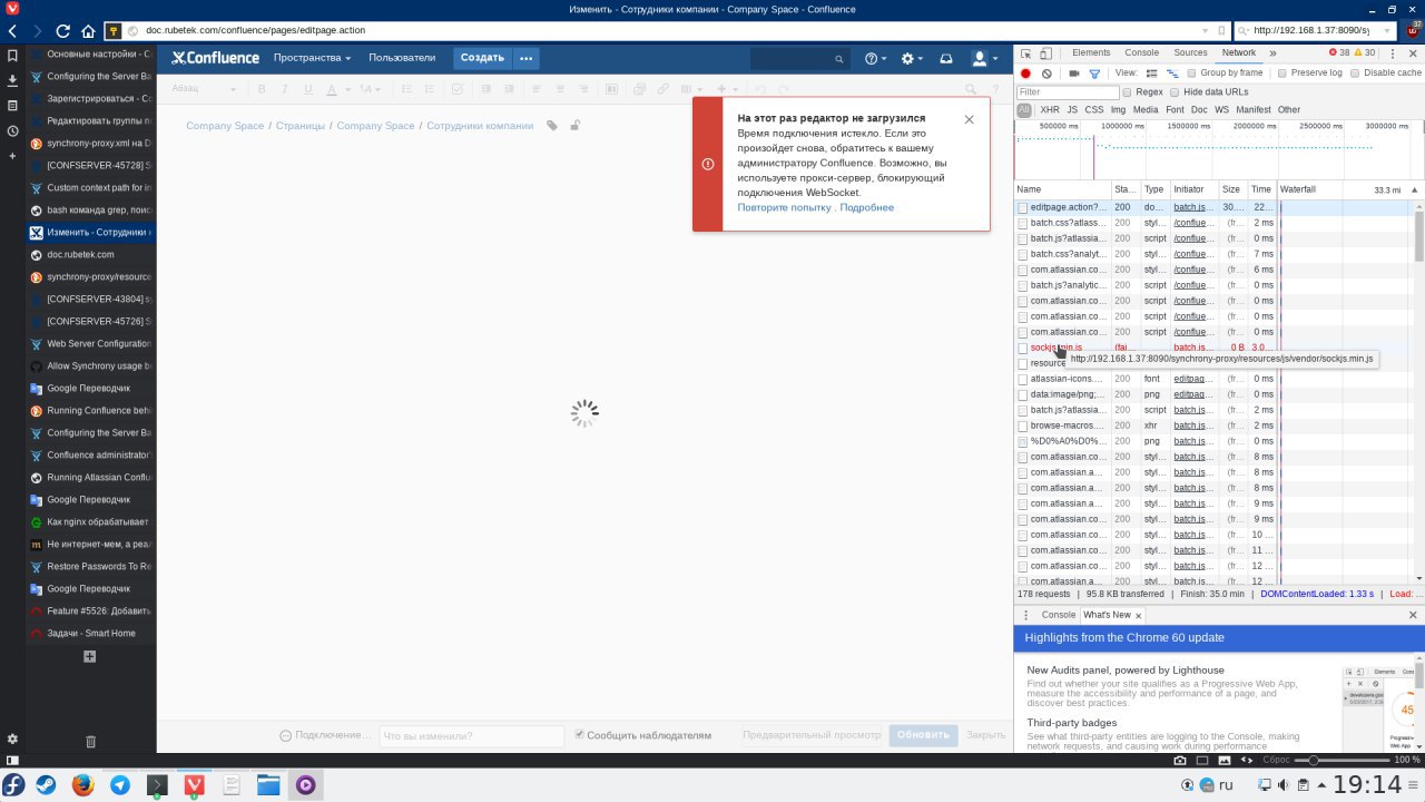

But, when we launch confluence editor,
One script file, will have url: http://192.168.1.37:8090/synchrony-proxy/resources/js/vendor/sockjs.min.js
(on screenshot)
Because of this doesn't work confluence editor.
Whats is this our error? Or maybe bag?
