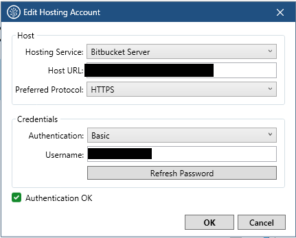

- I have 3 entries here for some reason as follows;
- 1 x Account with my username.
- 2 x saved passwords with my username.
- For the account entry, I went to Edit and was able to succesfully authenticate with my username and password.

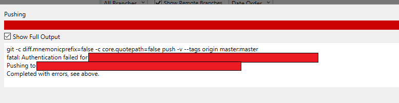

- After authenticating, attempted to commit, and was shown commit error with authentication failed.
