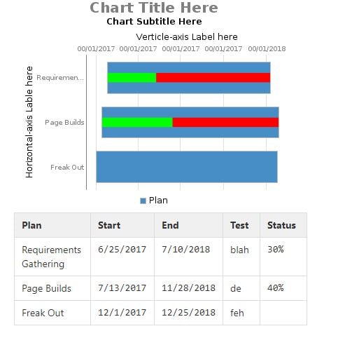

Using the information here: https://confluence.atlassian.com/doc/chart-macro-163415075.html
I created the attached gnatt chart.
I keep getting "Requires end >= start." if the dates are in the same year. A year out it works, but the date headings are nonsense.
- How do I get the dates to work in the same year without being told the end date needs to be greater than or equal to the start date (it is).
- How do I get the date columns at the top to be accurate?
- It would be great if you could give exacts to put in the parameters. I read through the Atlassian documentation, entered dates where I thought it made sense, and got the same results.
