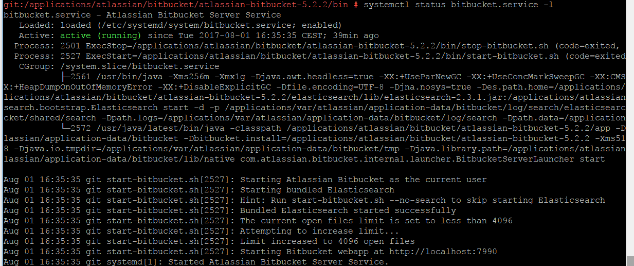

I have then followed the guide on how to setup Bitbucket as a service and it works perfectly (after a few more environment variables problems in script set-jre-home.sh. - command line was OK but when started as a service it lost track of the JRE_HOME).
Here is what the service looks like
When I try to reach the application on port 7990 I get a ERR_CONNECTION_TIMED_OUT
