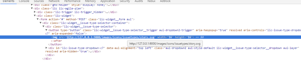

when loading pages thoughout jira, im having issues loading certain assets as jira create the html with wrong urls, i checked and the baseurl in settings is correct..
why its using http://127.0.0.1 instead of https://jira.baseurl?
also is it possible to load relatively? without the prefix of https://url/
