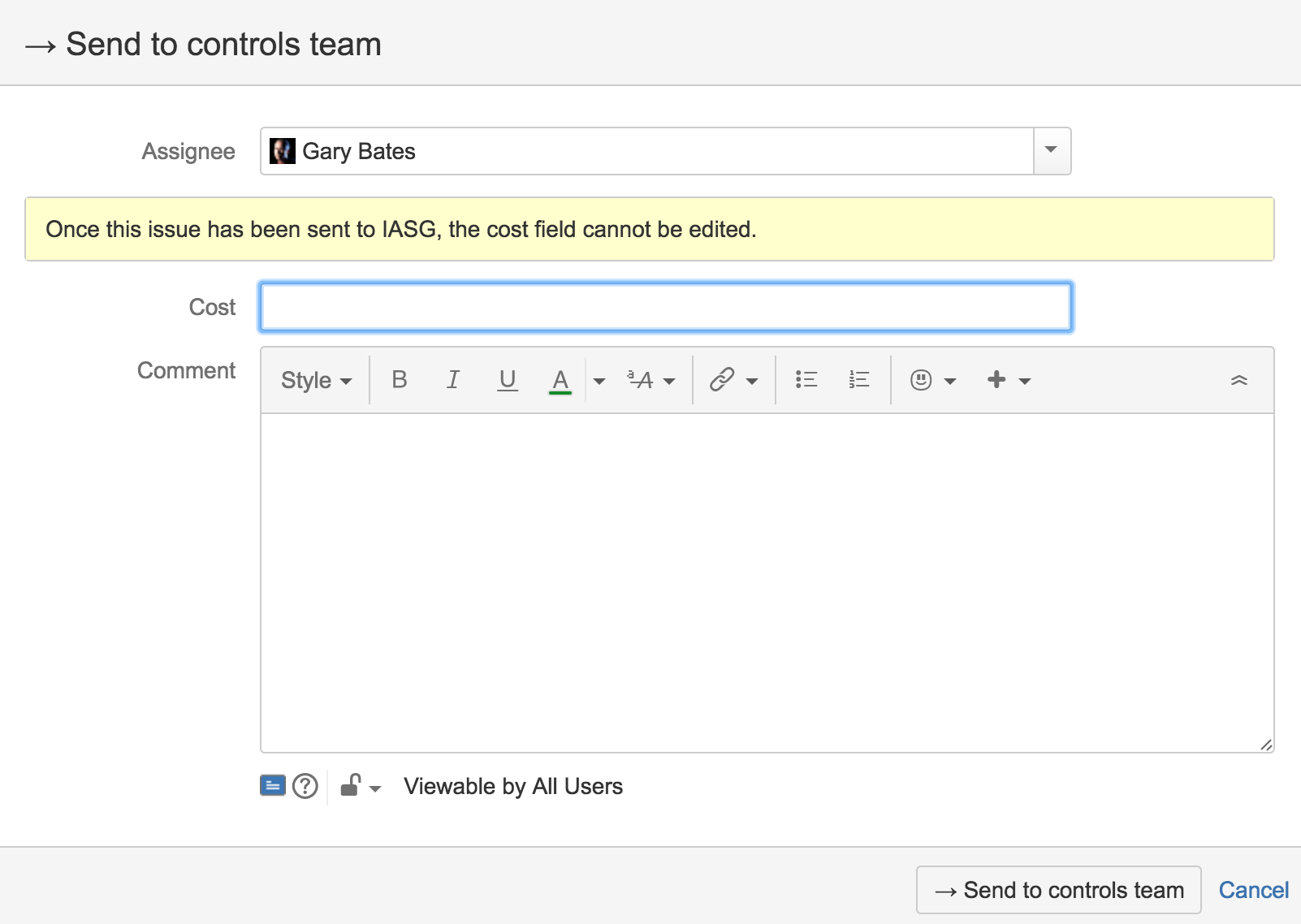

So how do the users specify cost at all? Well, I associate a screen with transitions at the start of the workflow asking the user to specify a cost:
In the early part of the process, they can specify the cost if they know it. The cost may be up to several tens of millions. If they don't know the cost at that point they can leave it NULL for the time being, or put it to zero, I don't mind and I don't check the value as it passes through those early transitions. Leave it NULL, make it zero, make it 20,000,000 (commas included for readability only) I don't mind.

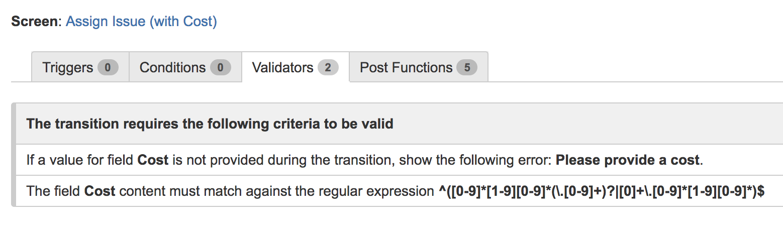

However, at a certain point in the workflow, I want to ensure that the value is not NULL and is greater than zero. The not NULL validation check is easy using a "Field Required" validator:
However, this does not check for the value zero, it is only checking for NOT NULL.
Remember, I want this transition to be possible (i.e. draggable on an Agile board), so I cannot use a Condition Validator that says "Cost > 0" - because if it's zero, then the transition is not even available - you will not be able to drag it to the next column on the board.
Therefore, I need a validator. As already shown, the "Field Required Validator" is only checking for a value, it does not check for numbers greater than zero.
The only option I see to perform this validation is the "Regular Expression Check" validator:
So I enabled this and gave it the following regular expression:
^([0-9]*[1-9][0-9]*(\.[0-9]+)?|[0]+\.[0-9]*[1-9][0-9]*)$
I tested this RegEx on a few online RegEx sites and it seems to do what I want, i.e. it won't allow zero, but will allow numbers above zero as well as values like 100.50, 100000.99 and such like.

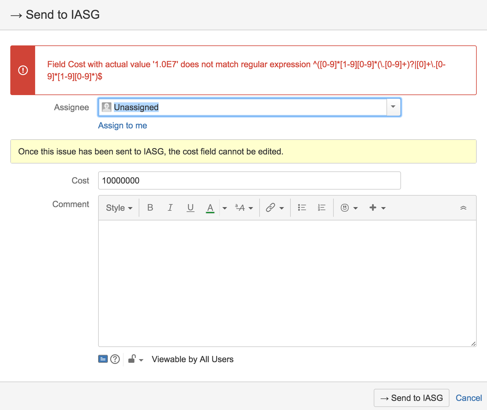

However, when I put this Regular Expression into JIRA as a validator:
Everything appears to work fine until you reach larger values. When the cost is 9,999,999.99 (I put the commas in for readability only) it passes the validator.
However, as soon as the cost value reaches 10 million the validator fails with the following message:
Not only is the validator message GOD AWFUL and not changeable, why on earth is it failing when it reaches 10 million? The RegEx looks fine.
I assume JIRA is doing something stupid with the value internally, converting it to exponential format (1.0E7) when it reaches 10 million which is then causing the RegEx validator to fail.
