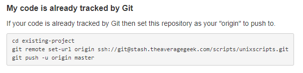

Here are the settings for another project on the same Bitbucket Server instance. As far as I can tell, they are identical to those of the first project linked earlier in my post.
Output from git when I try to commit a file from an existing repository in this project, following the instructions provided in the repository page:
$ cd unixscripts/
$ git remote add origin ssh://git@stash.theaveragegeek.com/scripts/unixscripts.git
$ git push -u origin master
Repository not found
The requested repository does not exist, or you do not have permission to access it.
fatal: Could not read from remote repository.
Please make sure you have the correct access rights
and the repository exists.
I would appreciate any input I can get on why the error is occuring with the second repository.
