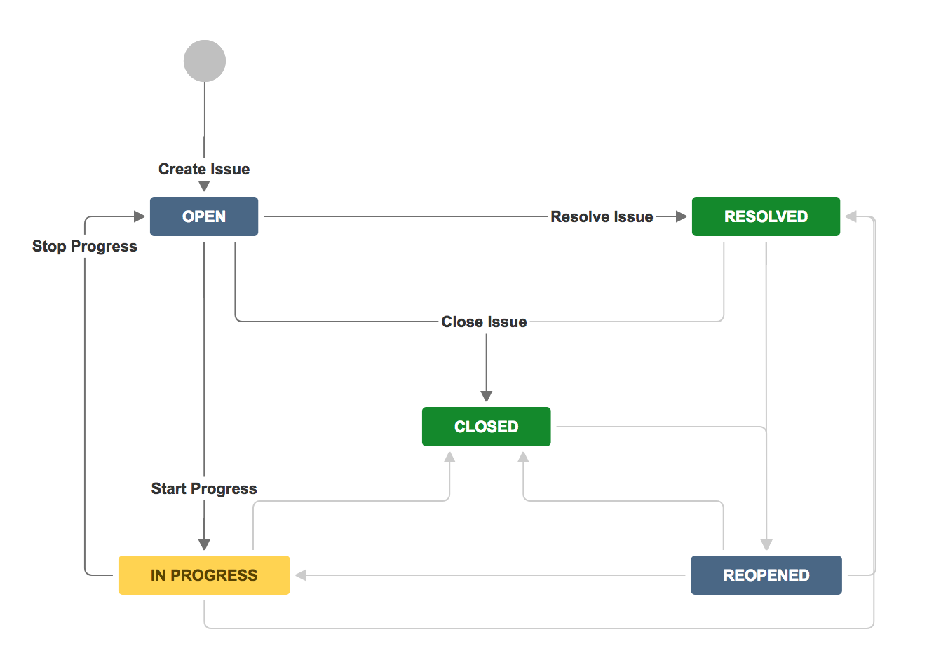

I create an issue that follows a workflow as shown below.
When i call `rest/api/2/issue/<issue-id>/transitions` after creating an issue (which is in `OPEN` status now) it returns below JSON
"expand": "transitions",
"transitions": [
"id": "4",
"name": "Start Progress",
"to": {
"self": "URL",
"description": "This issue is being actively worked on at the moment by the assignee.",
"iconUrl": "URL",
"name": "In Progress",
"id": "3",
"statusCategory": {
"self": "URL",
"id": 4,
"key": "indeterminate",
"colorName": "yellow",
"fields": {}
When i make the same call after i change the issue status to "IN PROGRESS" i get back
"transitions": []
My questions are
- In the first response shown above, i expected "CLOSED", "RESOLVED" along with "IN PROGRESS". But, i get back only "IN PROGRESS". Why ?
- I expected the second response to contain "CLOSED", "RESOLVED" and "OPEN" but, it returns an empty array. Why ?
- Please explain the responses from this API
- What call should i have to make to the next possible transitions ?
