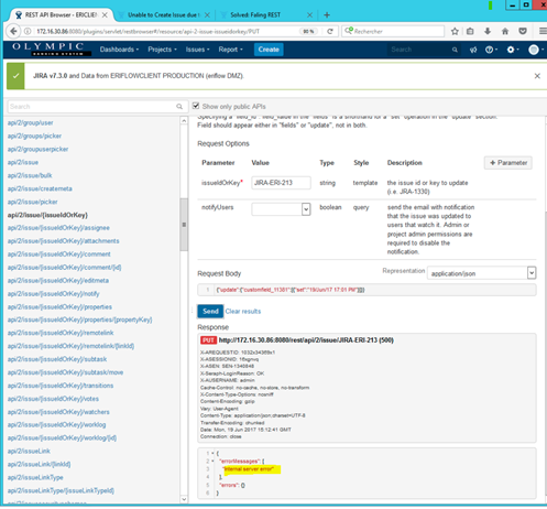

We try to update directly by Atlassian REST API Browser but we find the same resut that our jira service java code that's "500 Internal Server ERROR".
When we created the issue, there are not problems with these custom fields that are setted normally but the customfields are updated on production side end we need to update in customer side but we found this problem. We've tried to send the request body "{"update":{"customfield_11381":[{"set":"19/Jun/17 17:01 PM"}]}}" or "{"fields":{"customfield_11381":"19/Jun/17 16:01 PM"}}" with the same result from customer server 500 Internal Error and log of customer side server is:
