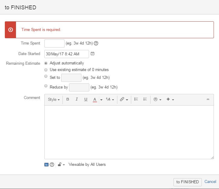

}Now I'm trying to move Key-89 to status "FINISHED".
Jira.transition_issue(issue, tFinished, fields={'timespent' : "6m"})Result:
{"errorMessages":[],"errors":{"timespent":"Field 'timespent' cannot be set. It is not on the appropriate screen, or unknown."}}
Unfortunately the hint on the other question in the Forum throws this error:
{"errorMessages":[],"errors":{"worklog":"Field does not support update 'worklog'"}}
Here is how it looks like in the WebUI:
Do you have anny suggestions?
