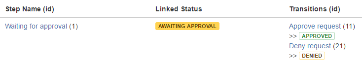

workflowTransitionUtil.progress();These two transitions, Approve request (id = 11) and Deny request (id = 21), exist in both the parent issue and sub-task workflows.

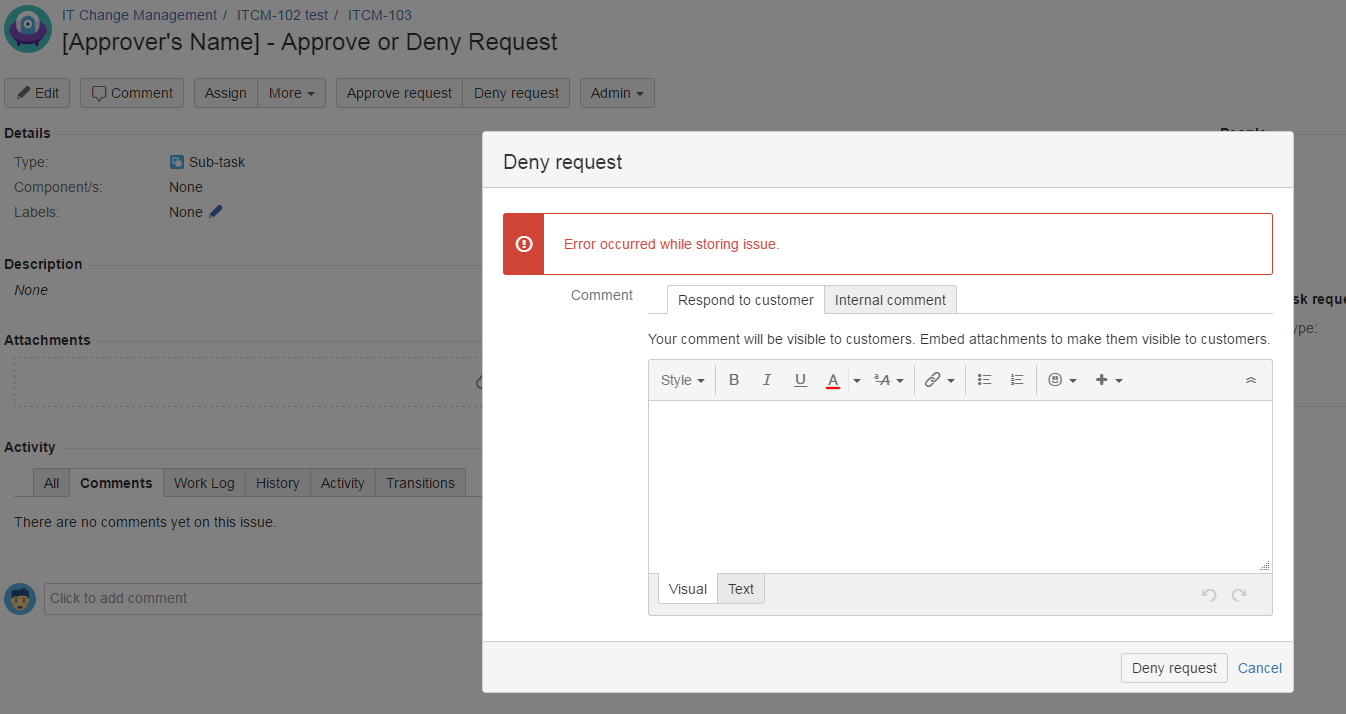

When I change setAction(11) to setAction(21), and try to execute "Deny request", I get the following error.
Is it a coincidence that setAction(11) happens to share an id with my Approve request transition? Or is that saying, "execute transition with id 11"? I'm confused why 11 works but not 21, when they are both transitions in my workflow.
It seems like replacing 11 with 21 should cause it to execute the parent's "Deny request" transition, since it successfully does the "Approve request" transition using 11.
