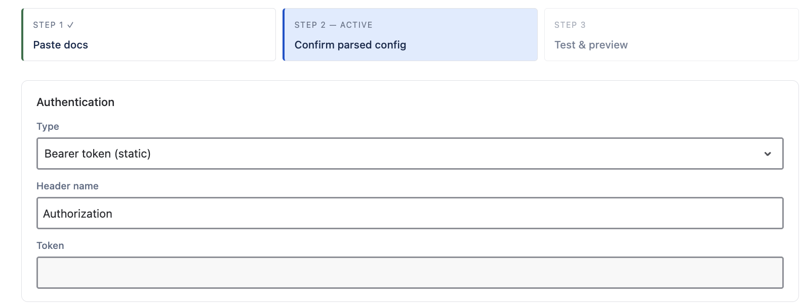

Authentication
Fleet uses bearer tokens. Every request carries the token in an Authorization header:
http
<span>GET</span> /api/v1/fleet/hosts <span>HTTP</span>/<span>1.1</span>
<span>Host</span><span>:</span> <span>fleet.yourcompany.com</span>
<span>Authorization</span><span>:</span> <span>Bearer <your_api_token></span>
From the Fleet UI (recommended for integrations). Log in to Fleet, go to My account → Get API token (/profile), and copy the value.
Create a dedicated service user for the integration rather than reusing a person's account.
Configuring authentication in OnLink
In OnLink, create the connection with the Bearer Token Static authentication type and paste the Fleet API token.

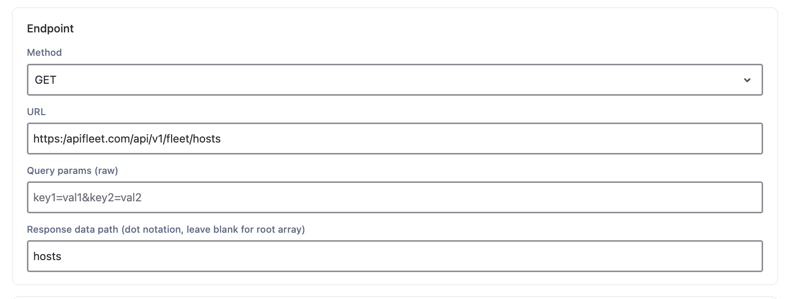

GET methods for hosts
API is GET /api/v1/fleet/hosts.
Set Method to GET.
Set URL to the Fleet API endpoint, for example: Fleet | REST API | Fleet documentation . In the sample below the URL use apifleet.com, please replace with your hostname.
Set Response data path to hosts.
Leave other settings at their defaults unless the endpoint requires query parameters.

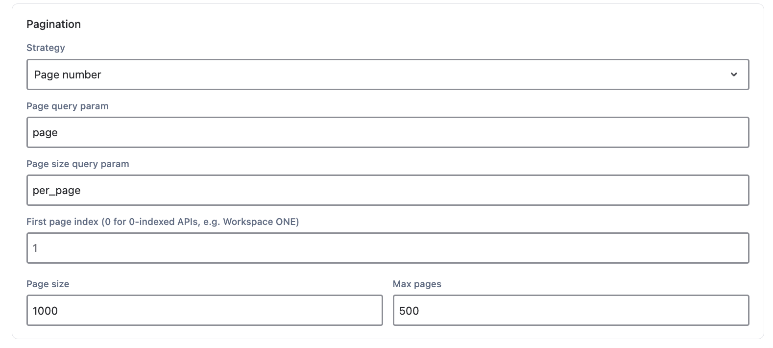

Additional configuration: pagination and filters
Pagination
