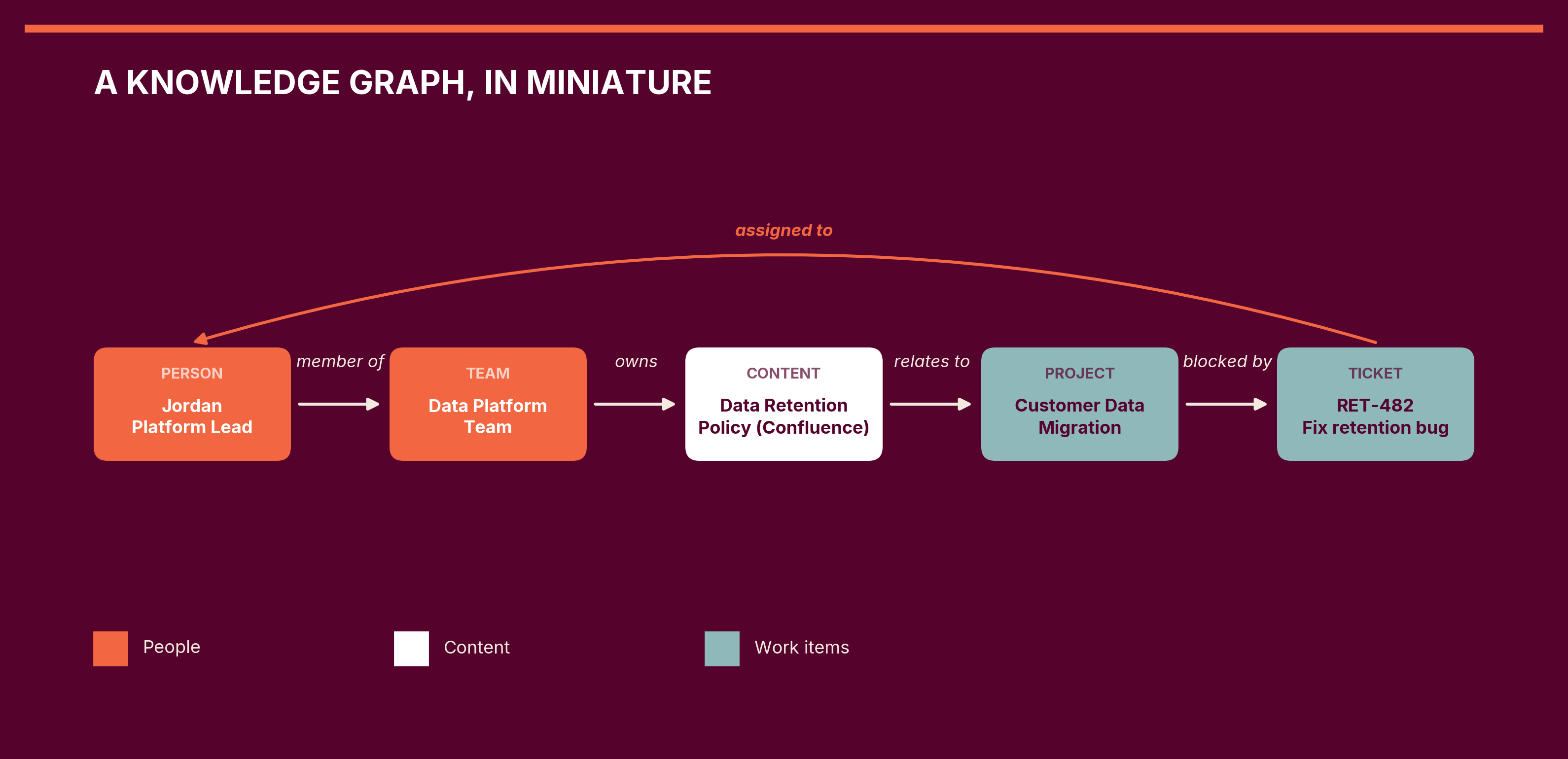

Map relationships, not just documents
A knowledge graph is a structured representation of entities — people, teams, documents, projects, decisions — and the relationships between them: authored by, owned by, supersedes, depends on, reviewed by, relevant to this team. Where RAG asks "what text is similar to this query," a knowledge graph asks "how does this piece of information relate to everything else, and who does that make it relevant, or accessible to?"
This distinction is why combining graph structure with retrieval (often called GraphRAG) is outperforming flat RAG on real enterprise workloads. LinkedIn's own production deployment of RAG plus a knowledge graph for customer service improved answer accuracy by 78% and cut median resolution time by 29%, according to reporting on the rollout. Microsoft Research's own GraphRAG work found that the graph-based approach required up to 97% fewer tokens than standard RAG while producing more comprehensive answers — because the graph already encodes the structure that flat retrieval has to rediscover, expensively, at query time.
Atlassian's own approach is a useful, concrete example for anyone running on Confluence or Jira. The Teamwork Graph unifies work data across Atlassian products and roughly 100 third-party apps, then "intelligently maps data to learn who you are, what you do, and how you do it" — building the connective layer that lets Rovo's AI features understand organizational context, not just document content. That's the graph doing what vector search structurally cannot: turning a pile of pages and tickets into a map of who owns what, who's involved, and how pieces of work relate.
The catch is that knowledge graphs are genuinely harder to build and maintain than a vector index — Gartner placed GraphRAG on its Hype Cycle with an estimated two-to-five years to mainstream maturity. The organizations getting value now aren't the ones with the most sophisticated graph technology; they're the ones with clean, well-structured source content and clear ownership to map in the first place. Graph technology amplifies structure that already exists — it doesn't invent it from a mess.
